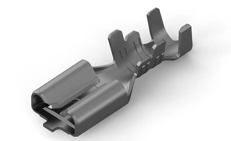

receptacle terminal
The dog bone shaped front end of the receptacle terminal allows tabs to mate on a milled surface instead of a sheared edge, and the receptacle’s locking dimple is on a cantilevered surface. These are among the features contributing to the receptacle’s low insertion force of only 6 lb. average, and improved ergonomics for assembly workers. Courtesy of TE Connectivity

Issues: The pounds of force that a connector requires to be properly mated greatly affect worker stress and productivity. When lower pound-force can be used to create a normal contact, the worker’s task may become easier. Insertion force is a factor of the coefficient of friction, resistance to abrasion and other mechanical variables. Connector design and materials play a key role in reducing friction. For example, a tin-plated brass receptacle terminal designed for low insertion force (LIF) requires six pounds (27 Newtons) of force on average, which is 40% to 60% lower than the ten to fifteen pounds of force required for non-LIF designs. In the case of point-to-point power connectors, LIF designs need a maximum mating force of only 1.5 pounds per contact. Of course, when 10 to 12 contacts are involved, the forces add up to 18 pounds of force or more for connector mating. High peak insertion forces of terminals assembled into the connector housing and connector mating raise a number of problems, which include the potential for:

Current generation soft-shell, crimp/snap connectors improve ergonomics with low insertion force (1.5 lb maximum) contacts, as well as molded components with rounded edges and large pressing/gripping surfaces. Additionally, they offer snag-resistant latches, keying and other features to ease assembly. Courtesy of TE Connectivity
Solutions: Today’s appliance manufacturers can employ advanced connector designs that improve on standard connectors that have not changed in decades. When encountering higher connector counts due to more signal and power lines in more complex appliances, workers can benefit from LIF terminals and/or connectors and terminals. In many situations, it’s worthwhile investigating the benefit that LIF connectors designs bring compared to applying a lubricant to the terminal to reduce mating forces. Newer designs offer benefits that may include:
