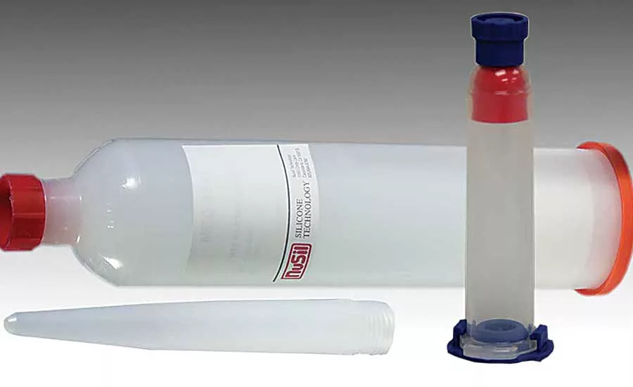

Silicone adhesives can be supplied in a variety of packaging. Photo courtesy Avantor

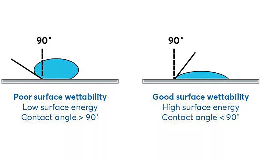

The receptiveness of a substrate to an adhesive is generally related to its surface energy, or “wettability,” which refers broadly to substrate acceptance of a coating. Low-surface-energy materials, like polyethylene, do not allow a liquid adhesive to easily “wet out,” or spread outward, across their surfaces.
The contact angle of a drop of water on the substrate surface helps quantify the wettability of the surface. In general, if the contact angle is below 90 degrees, the material has high surface energy and provides good surface wettability. If the contact angle is greater than 90 degrees, the material has low surface energy, with a greater likelihood of adhesion failure due to blank spots on the substrate surface where no adhesive is present.
Plastics, such as polyethylene, have very low surface energies, which can make it challenging to use silicone adhesives without proper surface preparation. Better wetting also enables greater interaction with the substrate. The silicone can more easily fill in the microscopic valleys on the surface to provide better adhesion.

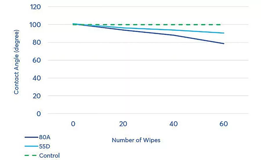

The first surface preparation factor studied was the effect of surface cleaning on surface wettability—specifically whether, and to what extent, multiple cleaning passes affect the contact angle on the two polyurethane substrates.
The surfaces of both substrates were wiped using isopropyl alcohol with a mechanical wiping device to eliminate inconsistencies in manual wiping, such as pressure against the substrate and area to be cleaned. The contact angle was measured after 20, 40 and 60 wipes and compared to the contact angle without cleaning. Results showed that cleaning the surface significantly improves the contact angle.

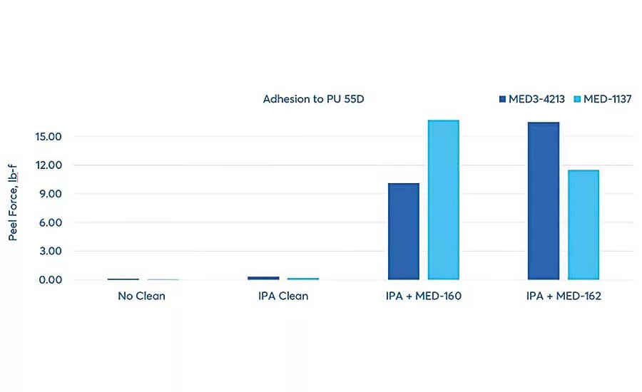

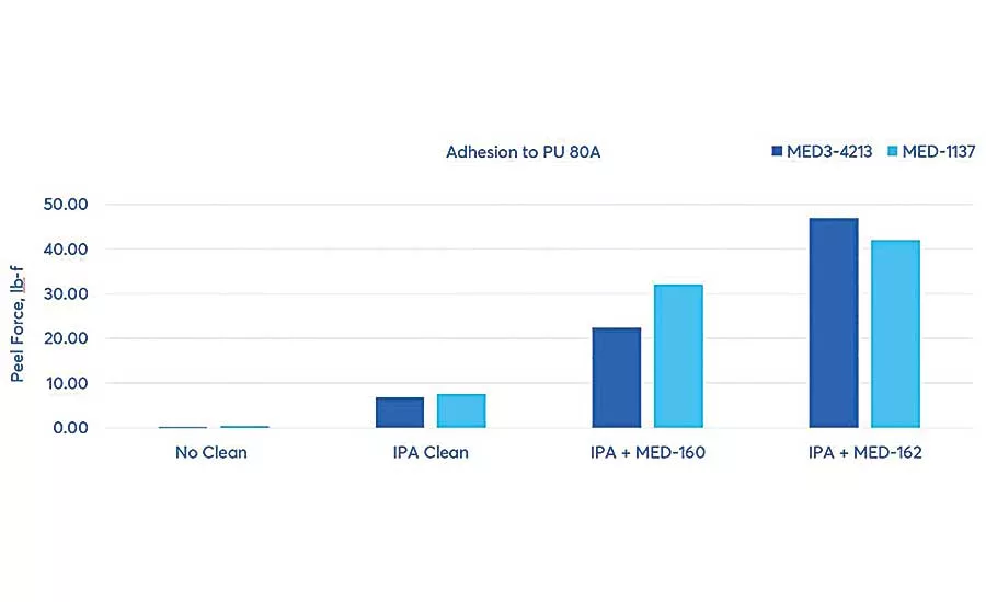

Next, the primers were applied to the newly cleaned polyurethane substrates. For each substrate, the peel force required to separate the polyurethane panel from the silicone was tested, assessing the effect of surface cleaning and the use of adhesive primers.
The first test assessed adhesion and the effect of surface treatments on Pellethane 2363 80A. The polyurethane panel and a sheet of silicone were adhered using MED3-4213 and MED-1137 silicone adhesives with and without the use of the two primers. Peel force tests were conducted using an Instron 3345 tensile tester set at a pull rate of 20 inches per minute, and the peak force was reported. Significant improvements were shown with surface cleaning alone, and even more so when primers were used. MED-162 primer provided the most effective improvement in adhesion for both silicone adhesives tested.
The tests were repeated on the Pellethane 2363 55D, using the same surface cleaning, silicone adhesives and surface primers. For this substrate, although only slight improvements in peel force were shown with surface cleaning alone, significant improvements were shown through the use of both primers. The combination of MED-160 primer and MED-1137 adhesive outperformed all other combinations.
