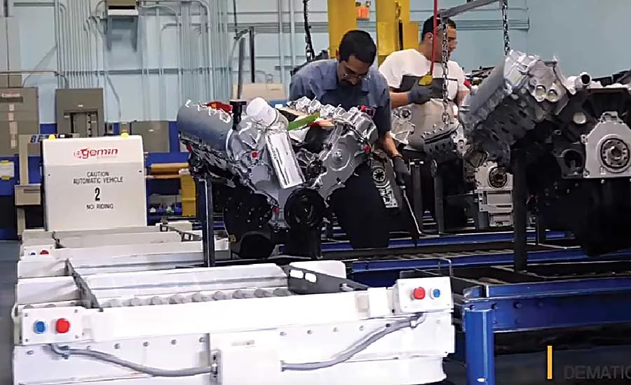

Tugger AGVs automatically transport and deliver remanufactured engines from several production areas in the AER plant to the shipping department. Photo courtesy Dematic North America

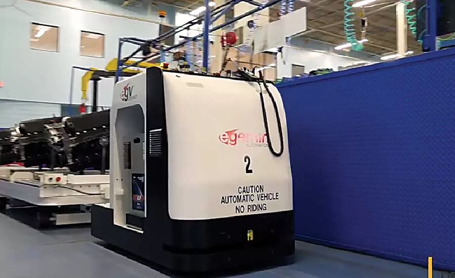

Once hitched to a load, the tugger uses laser navigation to move throughout the facility. Photo courtesy Dematic North America

Eventually, the company replaced its old system with several Egemin tugger AGVs from Dematic North America. The AGVs automatically transport and deliver engines from several production areas to the shipping department.
AER managers selected Dematic for several reasons. One is that the AGVs use off-the-shelf components, enabling AER to quickly get replacement parts and at a lower price than proprietary parts. Standard parts also increase reliability, while minimizing maintenance time.
Another reason is the vehicles’ hands-off operation. Workers no longer need to leave production lines to manually drive vehicles down long hallways. Instead, they use call buttons to request that a tugger AGV hitch to a pallet load of engines and transport it to shipping.
Once hitched to a load, the tugger uses laser navigation to move throughout the facility. This capability, along with automatic battery recharging, optimizes worker assembly time and safety,
while reducing product and equipment damage. All AGVs comply with ANSI B56.5-2012 and European (EN) safety standards and requirements.
The AGV has a rated capacity of 5 tons, with a maximum forward speed of 200 fpm and a grade of ±2 percent. It measures 58.5 inches long by 47.64 inches high by 32 inches wide. Operating temperature is 32 to 104 F.
