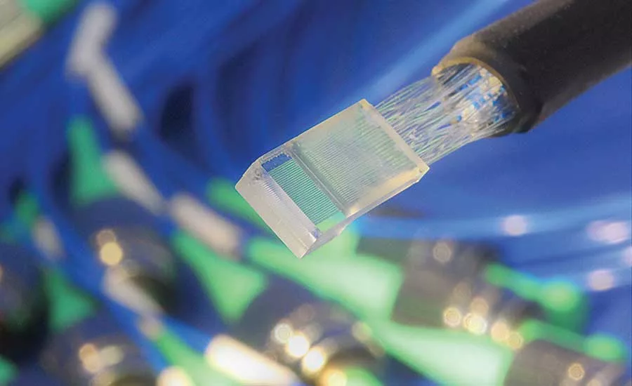

Optical fibers can transmit data at much faster speeds than aluminum or copper wire. Other benefits include smaller size and weight. Compared with copper, for example, optical fiber yields an average space savings of 25 percent and a weight savings of 50 percent. Optical fibers are also immune to electrical noise and can transmit data over longer distances than copper cable or wire.

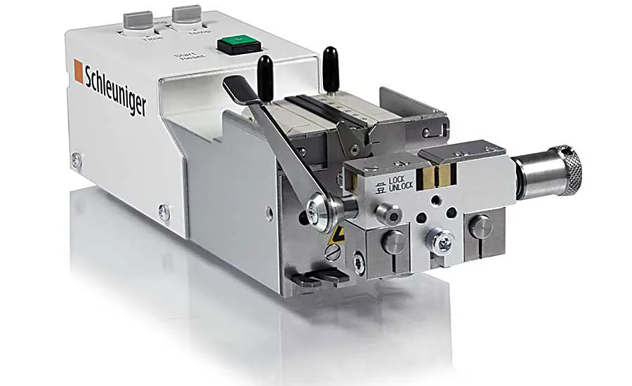

Fiber stripping is usually accomplished using hand tools or semiautomated benchtop equipment. Protective coatings are stripped away with blades or lasers. Heating systems are also used to soften the coatings so they can be easily removed.
“The big difference between optical fiber and copper wire is terminating connectors,” says Weeks. “It’s relatively simple to terminate a copper wire. But, attaching one or more fibers to a connector is a more involved process.”
“The quality of connectors today is much better than in the past,” adds Pete Doyon, vice president of product management at Schleuniger Inc. “However, connectors also keep getting smaller, which makes automation difficult. The most common size of connectors that we see used with our equipment is 125 microns. By comparison, single-mode fiber has a core size of just 9 microns. However, a multimode fiber has a larger core size.
“Demand for our fiber optic processing equipment has been steady, and it’s growing,” says Doyon. “Our most popular product is the FiberStrip 7030, which is a benchtop machine that strips the buffer and coating down to the bare glass. It strips fiber in a semiautomatic fashion without touching the glass fiber.”
The motorized machine is designed for stripping single coated and buffered fibers. Stripping speed, heating time and heating temperature are adjustable.
“Our equipment is primarily used to mass-produce pigtails and jumpers,” explains Doyon. “A pigtail is a short strand of cable that has one end attached to a connector; the other end gets spliced onto another cable. Lengths vary, but pigtails are typically made in 3-, 6-, 9-, 12- and 15-foot variants. Jumpers have connectors attached on both ends.

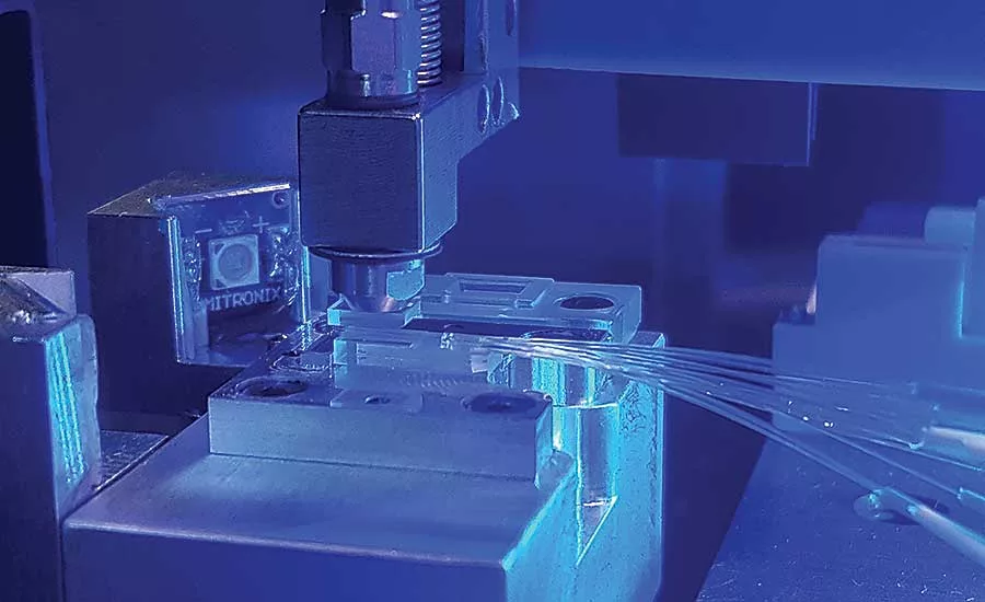

“Engineers typically rely on epoxy to attach optical fibers to ferrules, because they need a stable interface over temperature and lifetime,” explains Marrapode. “Quick-curing UV adhesives are also used for some applications—mostly in data centers that don’t have harsh environmental requirements or shorter lifetimes.”
“Adhesives are typically used to attach individual optical fibers or bundles of fibers to components,” says Nandivada. “Common applications include bonding optical fibers into connectors, potting fiber bundles and sealing fibers into ferrules.
“Adhesives are also used to assemble fiber optic components such as amplifiers, filters, isolators, switches and transceivers,” explains Nandivada. “Epoxy is frequently used for most assembly applications, but silicones, urethanes and UV curing systems are other options.
“We offer a wide variety of epoxies, ranging from chemistries that are more rigid with a low coefficient of thermal expansion to epoxies that are more flexible and feature excellent resistance to thermal cycling,” notes Nandivada. “EP30-2 is our most popular two-part epoxy product. It’s used for a wide variety of fiber optic assembly applications.
“UV curing is ideal for high-volume production applications that require throughput,” Nandivada points out. “A one-part material that doesn’t require mixing and measuring typically lends itself better to automation. These adhesives also cure extremely quickly when properly exposed to UV light.
“In some applications, however, silicones may be better, because they offer extremely low stress and good temperature resistance,” says Nandivada.

“The single fibers are tacked with a special UV-curable adhesive on a v-groove,” explains Berger. “With an optimized assembly process, the fiber tips are located close to each other afterwards.
