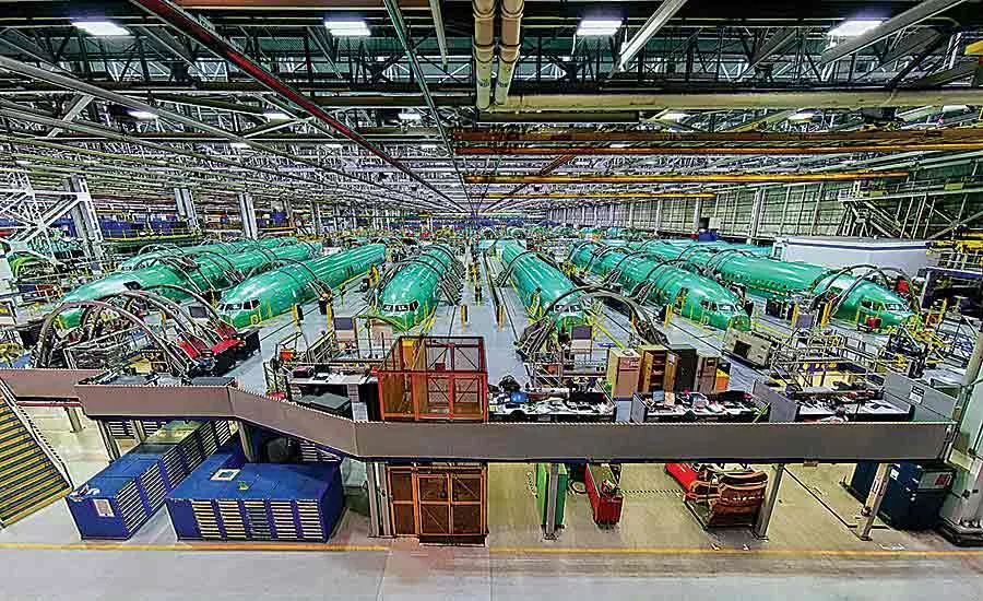

Aerospace engineers face numerous lightweighting challenges
Advanced Materials  Push the Envelope in Aerospace Assembly
Photo courtesy Boeing

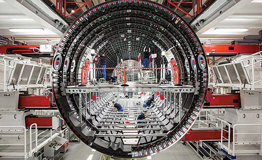

Aluminum is still widely used in aerospace applications, but advanced carbon-fiber composites and superalloys are becoming increasingly popular. PHOTO COURTESY PREMIUM AEROTEC

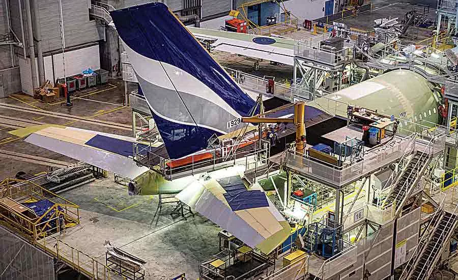

Aerospace engineers are using graphene-integrated composites to reduce weight and improve the performance of tailplanes and other airframe structures. PHOTO COURTESY AIRBUS SE

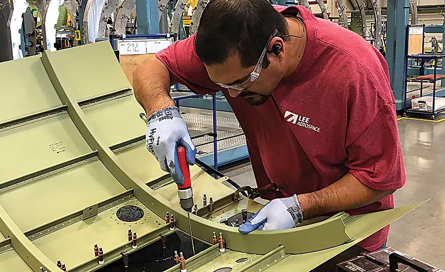

Joining dissimilar materials is a common headache for aerospace manufacturers. PHOTO COURTESY LEE AEROSPACE

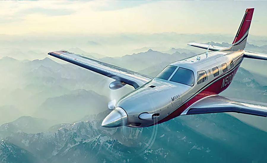

Additive manufacturing appeals to many types of aerospace manufacturers. PHOTO COURTESY PIPER AIRCRAFT INC.

Today, aluminum is still widely used in aerospace applications, but advanced carbon-fiber composites and superalloys now captivate the attention of engineers scrambling to increase efficiency, optimize performance and reduce weight.

When fasteners are used to join traditional materials, there are more holes to drill and fill. By bonding a composite structure together, aerospace engineers eliminate those headaches.
“Fasteners create numerous issues relating to tolerance and destacking,” Bullen points out. “They also contribute to lost-time injuries and defects.

“Integrating graphene and related materials into fiber-reinforced composites has great potential to improve weight and strength, and [it can] help overcome bottlenecks limiting the application of these [materials] in planes,” claims Vincenzo Palermo, vice director of the Graphene Flagship, a European organization that is working with manufacturers such as Airbus.
Graphene-integrated composites are constructed by introducing thin graphene sheets, a few billionths of a meter thick, into hierarchical fiber composites as a nanoadditive that improves the material’s mechanical properties.
“Graphene’s high aspect ratio, high flexibility and mechanical strength enable it to enhance the strength of weak points in these composites, such as at the interface between two different components,” explains Palermo. “Its tunable surface chemistry also means that interactions with the carbon fiber and polymer matrix can be adjusted as needed.”
The fiber, polymer matrix and graphene layers all work together to distribute mechanical stress, resulting in a material with improved strength.
