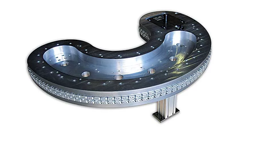

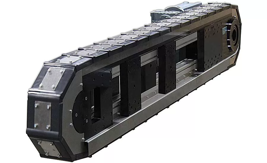

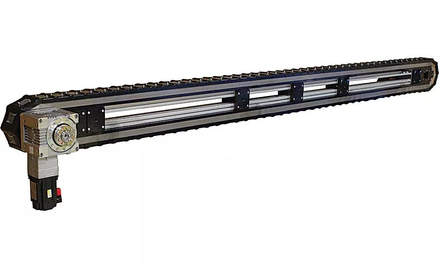

The precision link conveyor is not a typical conveyor. The conveyor is manufactured utilizing a rigid aluminum extrusion as its base chassis. This allows for very straight and rigid frame, while still keeping the mass of the conveyor low. This extrusion also allows the machine builder easy ways to mount accessories to the conveyor without having to drill and tap or modify a complicated structure. Mounted to the frame is a machined, hardened, and ground steel track. This track is the track for the conveyor moving chain. This track can be nickel plated or black-oxided as desired. Riding in this track is the chain, which is made of custom machined aircraft grade aluminum links. Each link has four cam followers in it, providing guidance and high accuracy to the track. The links are driven by a cam wheel at the drive end, and a take up cam wheel at the take-up, non-drive end. The cam wheel at the drive end is then driven by a variety of devices. It can be driven by a very high accuracy Motion Index Drives, Inc. index drive with AC motor, or with servo motor, or simply with a high accuracy servo reducer and servo motor.
The accuracy and application decide what drives the conveyor. If the accuracy of +/-0.1mm (0.004’’) is enough, a precision link conveyor without index drive, but with high accuracy servo reducer is ok. But, if higher accuracy is required, up to +/-0.05mm (0.002’’), utilizing an index drive maybe required. Utilizing an index drive to obtain a fixed index stroke may also prove to be the simplest and most cost effective way of integrating the precision link conveyor into the manufacturing process as the motor is just a simple AC motor capable of being driven with an open loop variable frequency drive with no encoder feedback required.
