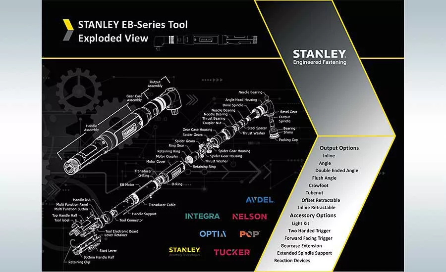

For a free Stanley Safety or Stanley Tool Exploded View Poster, for more information, setup a demo, or inquire about training, please contact STANLEY Assembly Technologies using the email SatInfo@sbdinc.com
