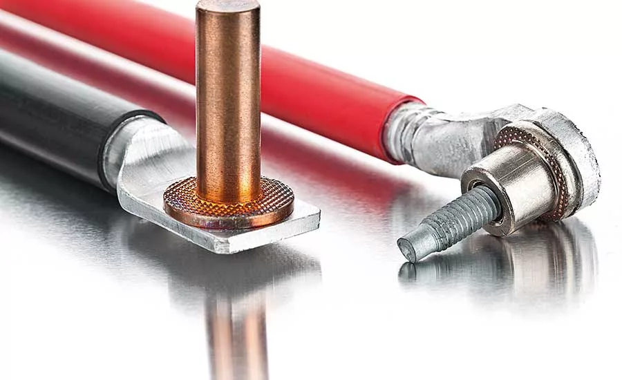

These photos show a copper pin and a threaded, nickelplated copper pin welded onto aluminum conductors.

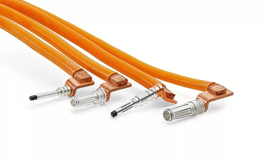

One way to ensure reliable connections in an automotive wiring harness—whether for autonomous vehicles or traditional ones—is with ultrasonic welding. The technology is a proven and reliable method for connecting wires to each other or to terminals. It offers fast processing times and extensive process control. The purely metallic connection is not subject to aging or fatigue. The firm bond also ensures very low contact resistance between components.
Ultrasonic welding can be used to join both similar and dissimilar materials, such as copper and aluminum. Additional consumables such as sleeves, solder or flux are not necessary, because the metals are welded together directly. In addition, ultrasonic welding produces low thermal stress on the parts. The material properties do not change and adjacent materials, such as insulation, remain intact.

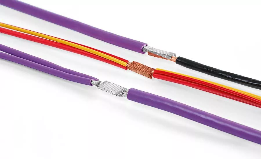

The connection point must be designed to withstand the mechanical, thermal and electrical loads during operation for the life of the vehicle. For example, the number of conductor strands to be joined together plays a role, because insertion becomes difficult above a certain number. To avoid rejects, no more than eight wires should be joined. Rejects can also be avoided by using an ultrasonic welding system that can detect incorrectly inserted strands.
To reliably detect missing strands, the smallest conductor cross-section should be at least 7 percent of the total cross-section. For joint cross-sections less than 5 square millimeters, that threshold is 9 percent. The largest cross-section should be no more than three times as large as the smallest one.
A special case when welding stranded wire is the symmetrical splice setup. If two to four conductors with the same cross-section are welded next to each other instead of overlapping, a vertical split splice may occur. This can be easily prevented by an asymmetrical node design. This sort of arrangement is not ideal, however, and is best avoided during the design stage.

When welding aluminum cables onto copper terminals, a nickel plating, 3 to 6 microns thick, on the terminals will ensure a high-strength connection. In addition, the points to be connected must be free of oil, grease, protective agents and dirt.
