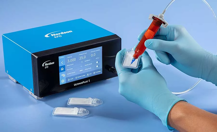

This touchscreen benchtop dispenser features full operator lockout and an optional bar code scanner for improved productivity. Photo courtesy Nordson EFD

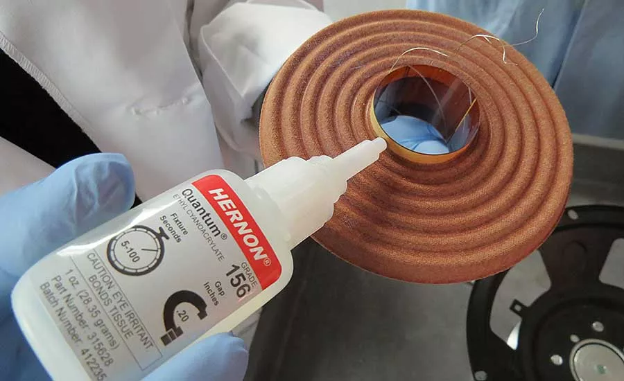

Cyanoacrylates are ideal for assembly applications where speed and strength are essential. Photo courtesy Hernon Manufacturing Inc.

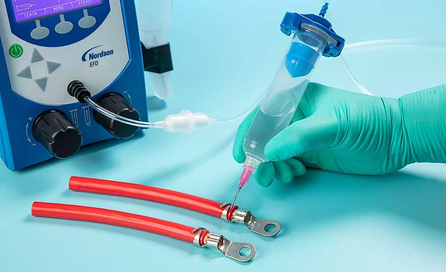

This dispenser features a barrier piston and PTFE-lined dispensing tips designed specifically for cyanoacrylate applications. Photo courtesy Nordson EFD

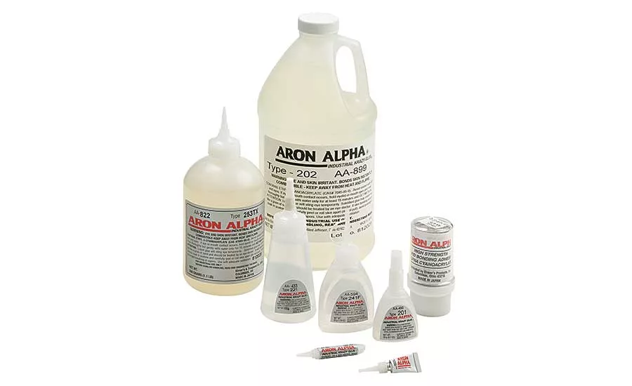

Cyanoacrylates come in a variety of packages, including cartridges, pinch tubes, squeeze bottles and syringes. Photo courtesy Toagosei America Inc.

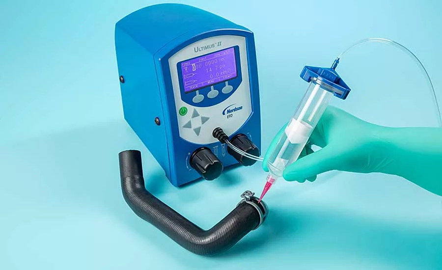

This benchtop unit is dispensing gel cyanoacrylate onto a rubber hose used in under-the-hood applications. Photo courtesy Nordson EFD

“With benchtop dispensers, if you don’t use the right kind of tip with CA, you’ll end up with clouding issues,” warns Muccino. “Whenever you have downtime, there can be challenges when a dispensing tip is exposed to air.”
When using a benchtop unit for low- to medium-volume production applications, Muccino recommends Nordson EFD’s UltimusPlus II or Performus X15, which enable engineers to set air pressure from 0 to 1 bar for greater control of low-viscosity CAs.
“Our PTFE-lined dispense tips prevent premature curing and clogging,” explains Muccino. “They feature a unique crimp to control the flow of watery CAs. And, SmoothFlow tapered tips provide the best results for gel CAs. In addition, our blue LV Barrier piston is designed specifically for watery CAs and other thin fluids, while our white SmoothFlow piston works great with gel CAs.”

“One of [our] most interesting products is our Quantum line,” explains Richards. “This is a series of rubberized and toughened CA adhesives that are more flexible and can be significantly stronger that traditional cyanoacrylates.”
