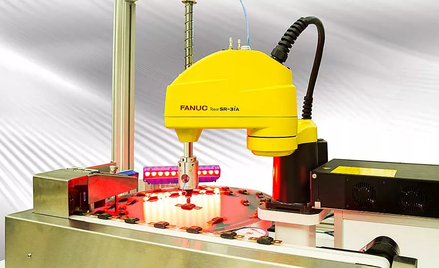

All FANUC SR robots are powered by the R-30iB controller. This model is handling electrical connectors. Photo courtesy FANUC America Corp.

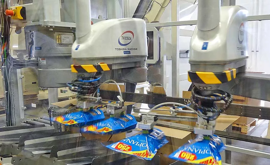

Shibaura makes many series of SCARAs. These ceiling-mounted TH1050A models are performing end-of-line packing of large packages. Photo courtesy TM Robotics (Americas) Inc.

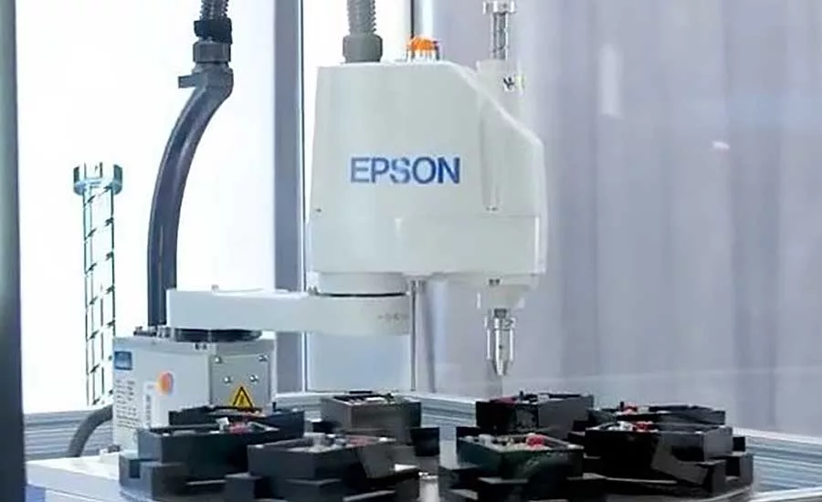

Epson’s T3 SCARA features a battery-free encoder and a controller built into its base, which eliminates the need for a separate control cabinet. Photo courtesy Epson America Inc.

In contrast, all SR series SCARAs made by FANUC America Inc. have a 360-degree work envelope. The robots’ slim and compact design eliminates the dead zone in the back so the SCARA can reach very close to its base, explains Ed Roney, national account manager at FANUC.
“Integrators and manufacturers were happy to see us introduce the SR series in late 2017, and it’s consistently grown in popularity ever since,” says Roney. “The SCARAs further complete our line of robots, which handle a payload breadth from 0.5 kilogram to 2,300 kilograms.”
Six models make up the SR series, including three- and four-axis models with a payload of 3 (3iA) or 6 (6iA) kilograms. The 12-kilogram SCARA (12iA) and 20-kilogram (20iA) SCARAs are four-axis models that come in standard and optional environmental versions. They were introduced in 2019.
Roney says the Z axis, or quill, is sturdy on all the robots, and features a hollow center—14 millimeters in diameter—to allow passage of air and electrical lines. He notes that the environmental versions are painted white, waterproof rated to IP65 and come with a bellows cover.
Another standard feature is the SCARA iRProgrammer software interface. Roney says it enables easy robot programming with tablets or PCs, and can be accessed via a Web browser. Integrators and end-users can program the SCARA by communicating with it through a standard HTML5 browser.
All FANUC SR robots are powered by the compact R-30iB controller, which uses high-performance hardware and advanced network communications to control all motion functions. These include integrated iRVision, force sensing and conveyor tracking.

The entire LS-B lineup from Epson, including the LS3-B and LS20-B SCARA robots, feature Quartz MEMS technology, a hardware and software system that combines vibration feedback and position for improved servo performance and reduced residual vibration. The robots also have a top-of-arm electrical and pneumatic layout with screw holes to mount additional equipment and enhance usability.
A battery-free encoder eliminates the need for users to halt the system to swap out batteries. This becomes a big advantage if several robots are simultaneously working on an assembly line.
Another helpful design feature is a low-profile cable duct for hard-to-reach workcell layouts, which contributes to the robots’ overall compactness. A built-in camera cable allows for easy vision system setup.
The LS3-B has a payload of 3 kilograms and a 400-millimeter reach, while the LS20-B has a 20-kiliogram payload and a reach of either 800 or 1,000 millimeters. ISO 4 clean room models are also available. The robots are compatible with the RC90-B controller that can be used for both PNP and NPN wiring configurations.
Epson’s T3 all-in-one SCARA has many of the same features, such as the battery-free encoder and low-profile cable duct. It also has a controller built into the robot’s base, which eliminates the need for a separate control cabinet, control box, or to run cables from the controller to the robot.
An on-board I/O communications port further increases functionality. This provides a direct connection to the controller and includes power for the end-of-arm tooling, making it easier to connect cables to the end effector and supply power to it.
The T3 plugs into a standard power receptacle and runs on 110 or 220 volts. It also offers easy-to-use setup and operation through the RC+ development environment, and has a low starting price of $7,495.
