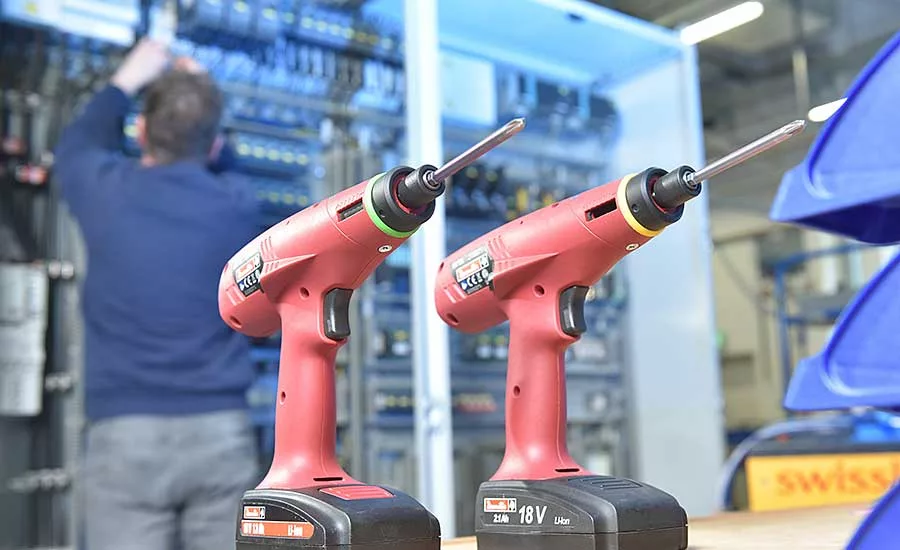

After the torque has been set, the cordless screwdrivers are marked with colored rings so that they can be distinguished at a glance. The torque is also written on the tool. Photo courtesy Desoutter

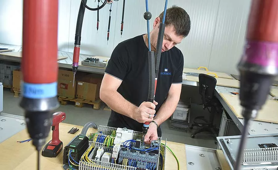

When the workpieces are horizontal, they can be conveniently assembled using pneumatic inline screwdrivers. Photo courtesy Desoutter

“When the workpieces are horizontal, they can be conveniently assembled using pneumatic inline screwdrivers,” says Volker Breit, safety officer at Hermos Schaltanlagen. “However, during the final wiring phase for a control cabinet, the assembly is in a vertical position. Managing the screw contacts neatly is not an easy task with inline screwdrivers.”
Hermos tried pneumatic screwdrivers with offset air inlets, but there’s still the air hose to deal with. “The operation is relatively exhausting, and I have to use greater force to put the bit on and hold it in the correct position,” says Birner. “The driver speed may be too high; the bit grip is not optimal; and in the worst case scenario, you slip and wreck components. And, the hose is always in the way.”

Appropriately adjusted screwdrivers are added for special cases. “The tools are marked with colored rings, and the preset torque printed is on them,” says Breit. “This almost eliminates confusion completely.”

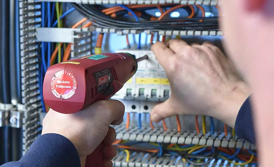

As a standard operating procedure, all the company’s tools are checked annually.
“At the start, we tested the screwdrivers every six months,” reports Messinger. “But since the error rate and deviations was always zero, this interval was extended.”
