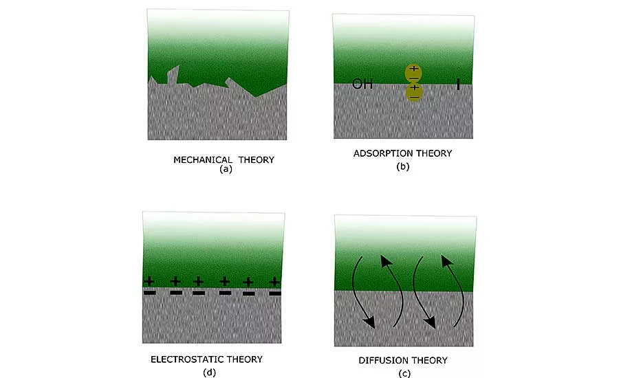

There are several theories about why adhesive adheres to aluminum. These include mechanical (a), adsorption (b), electrostatic (d) and diffusion (c). Illustration courtesy Free University of Brussels

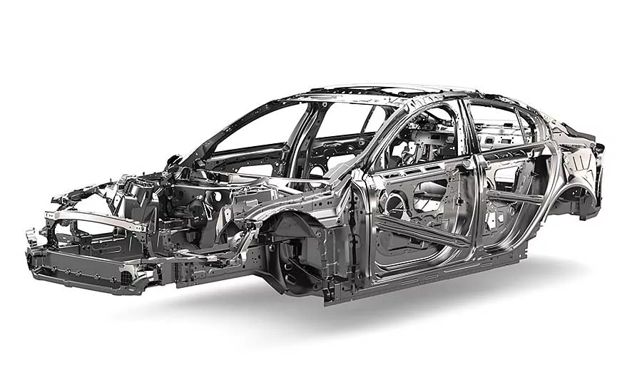

During the past decade, the average amount of aluminum in passenger cars has doubled. Based on the latest designs, this trend will continue in the coming years.
However, switching from steel to aluminum is not straightforward. For example, aluminum is 50 percent lighter than steel, but it has an average elastic modulus of 70 gigapascals, while that for steel is 207 gigapascals. As a result, aluminum parts are typically 40 percent thicker than their steel counterparts.
Aluminum alloys are not easily spot-welded. They have low electrical resistance, a stable and nonconductive oxide layer, and a tendency to interact with the electrodes. In addition, the heat from the welding process can weaken the parts, particularly their fatigue strength.

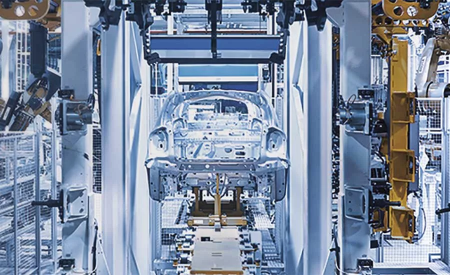

In lieu of welding, automakers are increasingly using structural adhesives for assembly, either alone or in combination with mechanical fasteners. For example, the body-in-white of the Mercedes S-Class coupe has more than 100 meters of structural bonds, and the BMW 7 series contains more than 10 kilograms of structural adhesive.
Besides structural applications, automakers are using adhesives in other body-in-white applications. “Anti-flutter” adhesives reduce vibration between outer and inner body panels. Such adhesives are commonly used on horizontal panels, such as the hood, trunk lid and roof. Adhesives are also used to join and seal the hem flange areas on doors, hoods and tailgates.

Adhesives can be used on aluminum sheets, extrusions and castings. Regardless of the form, the aluminum surface must be treated to:
  • Remove weak boundary layer formed by heat treatment or exposure to humidity, airborne contamination, oil and grease.
  • Enhance molecular contact between the adhesive and the substrate to promote the formation of intrinsic adhesion.
  • Create a continuous film on the oxide layer that is stable over a wide pH range, protects against hydration, and creates a barrier against corrosion.

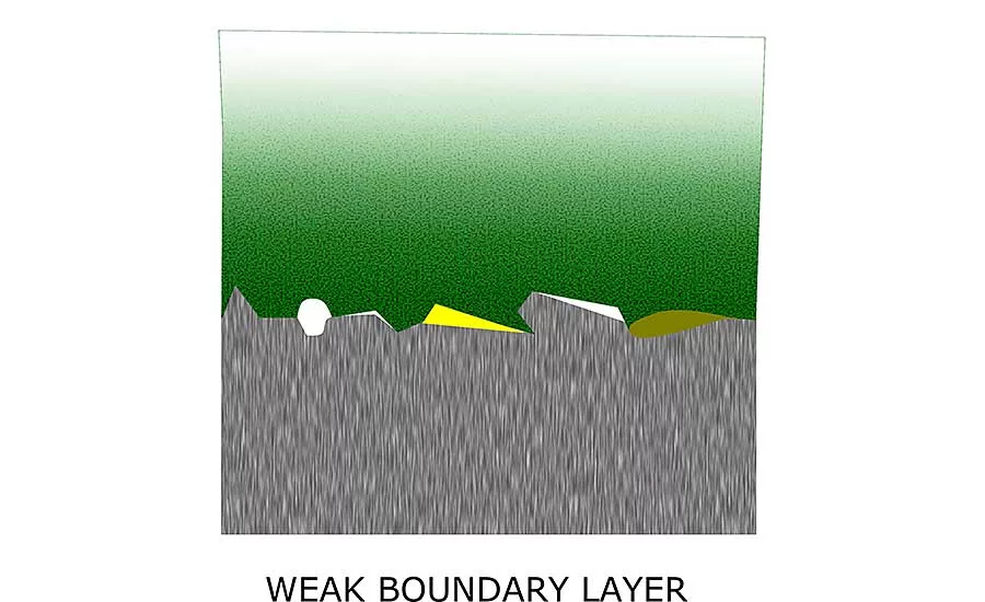

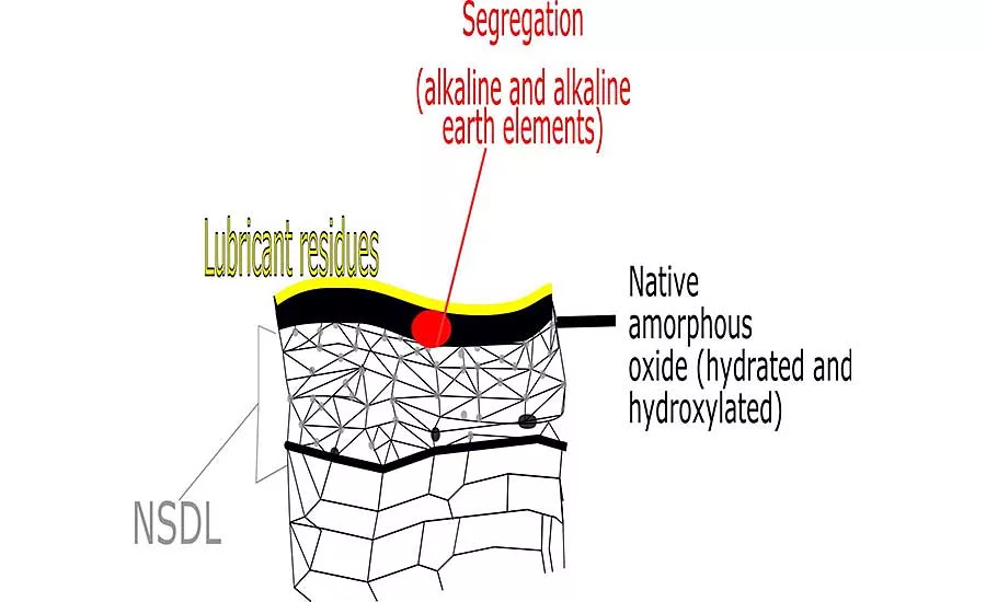

Removing the weak boundary layer is particularly important. This layer is formed at the interfacial region of an adhesive joint, causing the joint to fail at lower stresses than expected. This layer includes oxides and contaminants, such as lubricants, from various manufacturing processes. Surface preparation will most likely not remove this contamination completely, but it will produce a surface that will be less affected by cohesive weakness.
To produce aluminum sheets, aluminum undergoes a rolling process, either hot or cold. Lubricants are applied to keep the rollers and the workpiece separated. This minimizes friction and reduces the risk of damage to the surface of the sheet. The lubricants are typically paraffin-based and are volatilized during annealing or by natural evaporation. However, the rolled surface can still have a certain degree of contamination, which must be removed via degreasing.
Aluminum is very reactive and has a high affinity for oxygen. When it is exposed to air, a thin layer of oxides will instantaneously form on the surface.
If the oxide layer forms at a temperature below 375 C, it will consist of a thin, amorphous layer of Al2O3, 1 to 2 nanometers thick, covered by hydrated surface oxides and hydroxides. All totaled, the oxide layer can be 2 and 60 nanometers thick. Oxidation and hydration can be accelerated by the presence of alkaline and alkaline earth elements, such as lithium, sodium and magnesium, segregated at the surface or at the metal-metal oxide interface. Magnesium, in particular, can migrate to the surface during heat treatment. Aluminum hydroxides are actually good for interaction with the acid polar sites of polymers. However, hydration may reduce overall adhesion performance, since it creates weaker basic sites on the top surface.
If the oxide layer forms at a temperature above 400 C, the amorphous oxide may crack due to thermal expansion and crystalline Al2O3 can be formed. This can have a detrimental effect on total adhesion. The presence of magnesium also promotes crystalline oxide growth.
Cleaning and Pretreatment
Another characteristic of aluminum after rolling is the so-called near-surface deformed layer (NSDL). When the roller is biting the surface of the metal, it can initiate cracks in the oxide layer. As the sheet exits the roller, mill metal or intermetallics can stick to the roller’s surface. In successive rolling cycles, these particles get redeposited on the surface of the sheet and create even more imperfections or cracks in the oxide layer. This process creates a layer on the surface of the aluminum that is different from the underlying metal. This layer is the NSDL.
The thickness of the NSDL varies between 1.5 to 8 microns, depending on the rolling mill. An NSDL can form during both hot and cold rolling. There is a strong correlation between the presence of an NSDL and the susceptibility to filiform corrosion for 3xxx and 5xxx aluminum alloys.

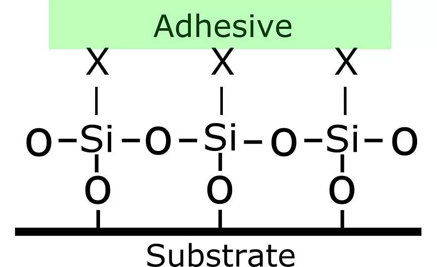

Among coupling agents, silanes are used the most. The role of coupling agents is to improve the degree of cross-linking in the interface region to increase chemical bonding. Silanes can form chemical bonds with both the substrate and the adhesive. The advantage of silanes is that they are simple and stable, due to their covalent cross-linked structure. They also improve surface wettability. The one drawback of silanes is their relatively short shelf-life.
Organophosphonic acid-based coatings are also used as coupling agents. Organophosphonic acids form very stable monolayers on aluminum alloys covered with a thin oxide film. The presence of phosphonate monolayers enhances adhesion with aluminum oxide. These acids can be applied via dip coating or spraying.

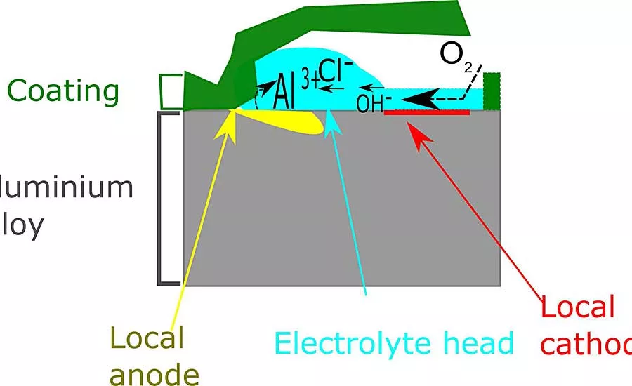

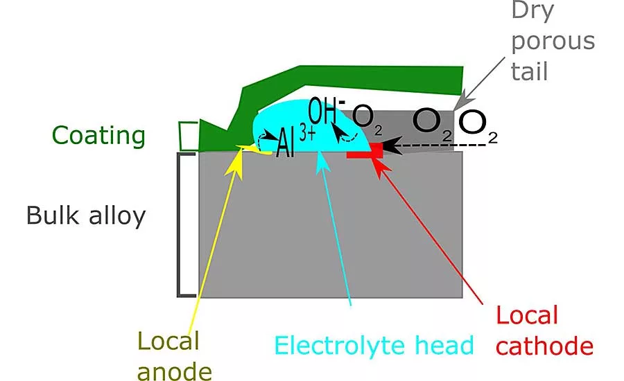

Filiform corrosion is a form of atmospheric corrosion that occurs under organic coatings in the form of narrow interconnected thread-like filaments. It was observed for the first time in the late 1960’s where it occurred around rivet heads and the edges of the aluminum skins on aircraft exposed to aggressive tropical environments.
In the case of polymer layers on nonconductive oxide surfaces, as on aluminum alloys, filiform corrosion is due to anodic delamination. The loss of adhesion is caused by the anodic dissolution of the substrate. The main environmental factors that are crucial for the initiation and proliferation of this form of corrosion are relative humidity above 80 percent, the presence of aggressive ions such as chorine, and defects in the protective coatings.
