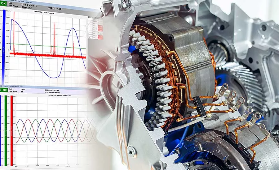

Testing of different, and often interconnected, parameters are required to determine the functional behavior of EV components. Illustration courtesy Marposs S.p.A

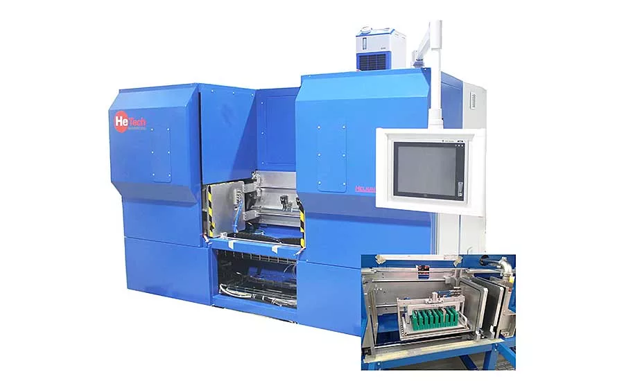

Nondestructive leak testing machines can help identify the presence of leaks in prismatic or cylindrical battery cells, modules and battery pack assemblies. Photo courtesy Marposs S.p.A

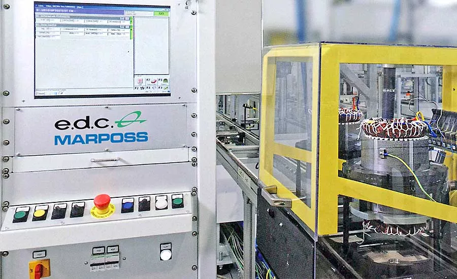

In-line insulation testing of a stator with partial discharge measurement can prevent motor insulation failures. Photo courtesy Marposs S.p.A

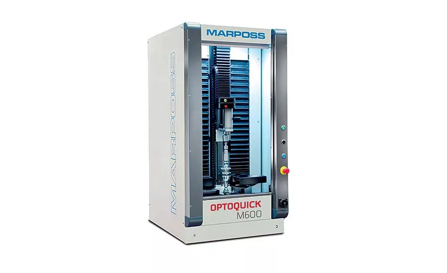

Optoquick is a flexible dimensional measurement machine that is ideal for testing rotors used in EV motors. Photo courtesy Marposs S.p.A

A striking example is represented by the tightness controls required on EV battery packs. All automakers define sealing standards (from IP67 up to IP6k9k) which ultimately refer to the need to ensure the impermeability of the pack from water or other forms of infiltration that could compromise its functionality.
However, the IP specification actually refers to a functional type of performance that may depend on various factors, including the methods of design, execution and assembly. These variables are unlikely to translate into univocal test specifications. As proof of this, the leak test specifications defined by different producers can differ by various orders of magnitude, although the required function is always the same: to guarantee the perfect sealing of the pack.
In cases like these, engineers must be able to adapt to different specifications, with different parameters that can range from tests in air (pressure drop or mass flow) to more sensitive tests with tracer gas, by sniffing technologies or in accumulation or vacuum chambers.
Engineers must also take into account the fact that testing specifications could change and become more stringent when particular types of failure are found in the field. As a result, it’s important to provide a sufficient degree of flexibility and be able to adapt to regulatory standards that may be still evolving.
Another critical challenge with EVs concerns the insulation tests on electric motor components (typically stators or wound rotors). The tests imposed by the regulations (such as surge or hi-pot) can, in fact, only identify the existing insulation defects. They are not able to highlight latent defects, which can trigger perforation of the insulation and generate defects that will appear only with the use of the motor.
However, the use of partial discharge test techniques that we usually suggest to identify latent defects is not yet imposed by automotive regulations. In the future, more OEMs and suppliers will be forced to adopt them to improve the reliability of their products.
