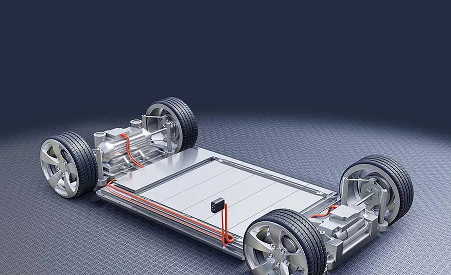

Electric vehicles require effective, efficient and durable cooling systems. Photo courtesy ESI Automotive

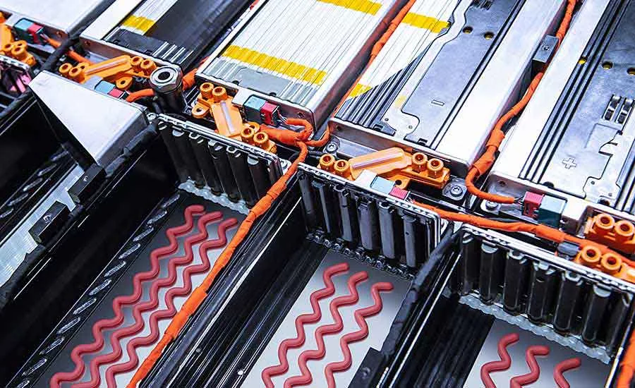

Thermal management is essential to the safety and long service life of battery modules. Photo courtesy Renault Group

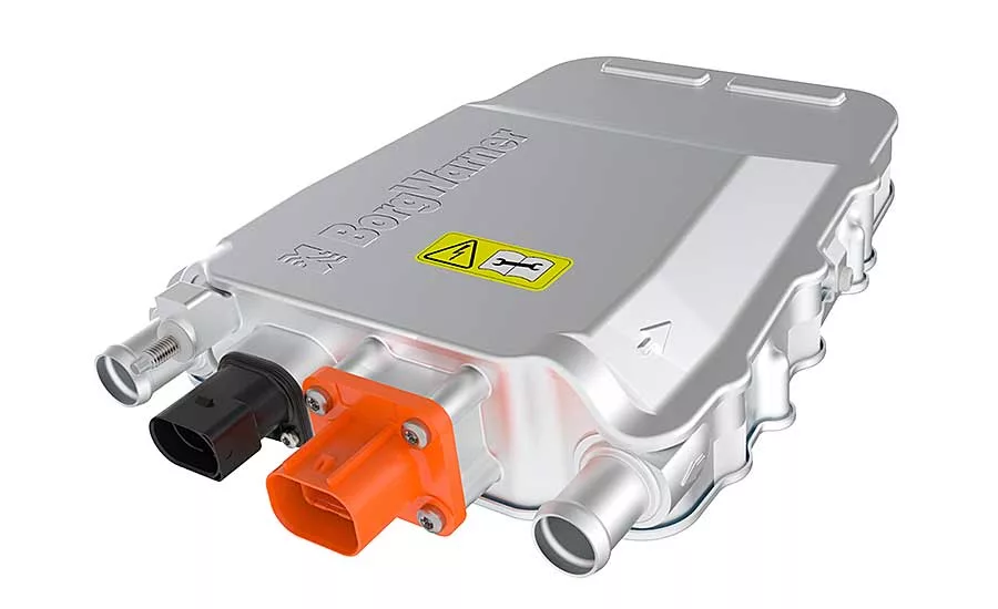

This high-voltage coolant heater solves two problems in a single device. Photo courtesy BorgWarner Inc.

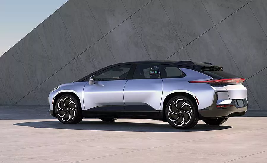

Faraday Future’s FF 91 will use a liquid cell submerged onboard cooling system. Photo courtesy Faraday Future Intelligent Electric Inc.

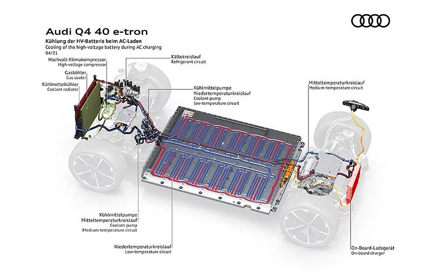

Four separate coolant circuits regulate temperature in the high-voltage components. Illustration courtesy Audi AG

Renault engineers have worked with DuPont Mobility & Materials to tackle several heat-related issues. For instance, they rely on Betatech thermal interface material to help safely manage and control heat from higher-density batteries during both charging and operation of EVs.
According to Le Borgne, this is accomplished by maintaining thermal conductivity through good contact with no gaps between the battery cells and the cooling plate over a wide operating temperature range. Betatech thermal interface material is available as a one-part or two-part dispensable thermal-conductive polyurethane product applied between the battery module and heatsink. It’s formulated for fast-dispensing in high-volume assembly environments.

Engineers at BorgWarner Inc. recently developed an advanced high-voltage coolant heater (HVCH) that will be used in the new Zeekr 001 electric sedan being produced in China by the Geely Auto Group. It solves two problems in a single device.
The HVCH helps improve range by controlling the battery temperature at an optimal level, while addressing passenger comfort by delivering an ideal interior climate. By offering consistent temperature distribution inside the battery pack and its cells, the heaters can also improve battery energy performance.
“HVCH technology was developed to meet the demand for fast-acting solutions as the thermal management systems of vehicles increasingly become decoupled from the internal combustion engine—permanently in the case of EVs and for longer parts of the drive cycle in hybrid electric vehicles,” says Joe Fadool, president and general manager of BorgWarnerv Emissions, Thermal and Turbo Systems.
“In addition, it allows comfortable cabin temperatures to be generated in a short time, enabling a better driving and passenger experience,” claims Fadool. “With high thermal power density and fast response time due to their low thermal mass, these heaters also extend pure electric driving range as they use less power from the battery.”
The HVCH features state-of-the-art thick film element technology. Heating elements are immersed in coolant so that power losses are minimized. The technology also enables direct temperature sensing.
“The HVCH is available in two versions—single plate and dual plate—both integrated into robust aluminum housings that provide excellent electromagnetic shielding,” explains Fadool. “Suitable for applications with supply voltages between 180 and 800 volts, the HVCH offers a power range of 3 to 10 kilowatts. The devices are protected from overheating, as the system switches off automatically in the event of a failure occurring.”

M&I Materials has been working with engineers at Faraday Future Intelligent Electric Inc. on the startup company’s FF 91 luxury EV, which will feature a fully submerged battery cooling system. Production on the much-anticipated vehicle is scheduled to begin in July 2022 at a state-of-the-art factory in Hanford, CA.
MIVOLT’s advanced dielectric coolant materials will be used in Faraday Future’s patented liquid cell submerged onboard cooling system, which includes a self-contained and fail-safe architecture battery pack design.
“We are working with leading-edge technology partners to advance our technological innovations and MIVOLT continues to build on a reputation for innovative products and superior technical knowledge,” says Bob Kruse, senior vice president, product execution and vehicle engineering at Faraday Future.”
“[We] explored numerous cooling methods as [our] variable platform architecture was designed,” explains Kruse. “[We] eventually devised a fully submerged system where all major battery components are submerged in coolant.
“Battery cells perform their best at room temperature, but as they release or store energy, they tend to get hot,” Kruse points out. “Therefore, the cooling scheme becomes crucial to ensure top performance during the useful life of the vehicle. The coolant [we] chose is a nonconductive liquid with thermal properties that allows the battery pack to have uniform temperature across all its components.”
The cooling system also eliminates potential risk of corrosion, because all electrical components and their connections are submerged in the fluid. Faraday Future engineers reduced the spacing between cells and increased the total energy density of the pack so the coolant can flow freely.
It also provides a natural dampening effect relative to component vibration. The battery pack used in the FF 91 incorporates an innovative coolant flow design that enables each cell to be individually cooled.

The lithium-ion battery system used in Audi’s e-tron GT quattro and RS e-tron GT relies on a complex thermal management system. It integrates 33 cell modules, each of which comprises 12 pouch cells with flexible outer skin. Each module is fitted with its own computer that monitors temperature and voltage.
The inner structure of the battery housing, the frame surrounding it and the upper cover plate are made of aluminum. Beneath the cell space of the battery, there is a compound structure of flat extruded sections through which a glycol-water mixture flows. The mixture circulates in its own low-temperature circuit.
The temperature is transferred between the cooling plates and the cell space via a heat-conducting paste. The battery’s optimal temperature is between 30 and 35 C, while its operating range extends from -30 C to 50 C.
Four separate coolant circuits, each at its own temperature level, regulate temperature in the high-voltage components precisely and quickly. They can be interconnected flexibly as required. If the driver demands a high output several times in a row, valves couple the coolant circuit of the battery with the refrigerant circuit of the air-conditioning system. This intensive cooling keeps the performance of the drive at a consistently high level.
The refrigerant circuit also helps with cooling during fast DC charging, which can heat the battery up to 50 C. The thermal management system is connected to the navigation system.
When the driver sets an HPC (high power charging) terminal as the destination, the cooling of the battery is already intensified on the way to the charging station so that it can be charged as quickly as possible. Should the battery still be very cold shortly after the car is started in winter, it is heated for fast charging.
