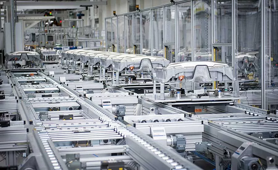

Keeping up with growing EV demand while also accommodating changes in battery technology will require flexible assembly lines. Photo courtesy Webasto Group

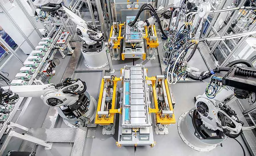

Battery manufacturers must adopt new ways of thinking about production processes to maximize speed, flexibility and throughput. Photo courtesy Skoda Auto

Keeping up with growing EV demand, while also accommodating changes in battery technology, will require flexible assembly lines. Traditional conveyance systems may only slow you down.
For decades, automotive manufacturers have relied on chain-based conveyors to advance parts through the production process. These systems use motion-control technologies with hundreds of mechanical parts, like rotary-driven chains, belts and gear boxes. Moving large parts across the factory floor can result in unforeseen safety incidents and transportation inefficiencies.
These fixed systems have limited flexibility, as well as operational speeds and maintenance requirements that may fall short of your gigafactory’s needs. A better alternative is a motion control system with independent cart technology.
Independent carts that ride on a roller-supported flexible track give you control over positioning. They also enable you to put multiple products in different package and format sizes on the same line, utilizing integrated position sensing to allow individual control of separate carriers on a loop-style track.

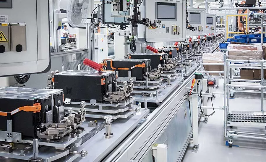

The system’s capabilities range from individual cell sorting to full battery module and pack assembly, while also performing required testing. The machine incorporates linear servo motors that position loads in precisely the correct direction at high speeds. And changeovers simply involve selecting the correct mode from the operator interface.
Free from the constraints of a traditional conveyor, this system can improve your operations by helping you create faster, more flexible battery lines using independent, programmable movers. Time to market is improved by new LSM technology thanks to built-in full-line simulation capabilities that include an integrated track-and-trace system that eliminates the need for external sensing.
Intelligent conveyors also reduce changeover times with simple software profiles that allow you to change products just by pushing a button. The software houses comprehensive code libraries that reduce program complexity, making vehicle routing more straightforward. Anti-collision programming and automated queuing are built-in, increasing both safety and efficiency.
