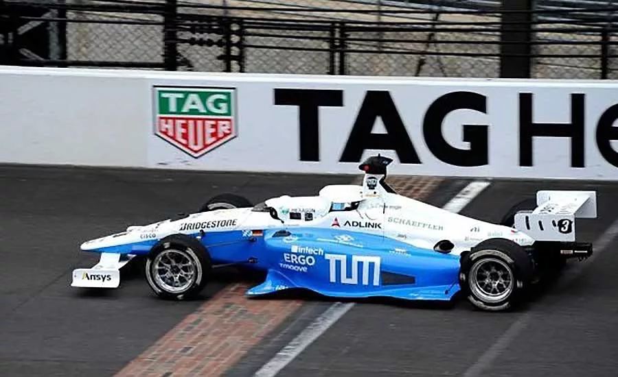

The IAC was not a traditional head-to-head race. Instead, it resembled more of a time trial, with only one car allowed on the track at a time. Each team was required to compete in a fastest-lap competition that included an obstacle avoidance component. TUM recorded the fastest two-lap average speed of 135.944 mph on the world-famous 2.5-mile oval race track.

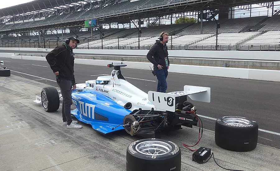

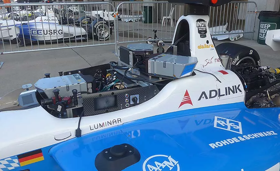

The cars used for the IAC competition were modified Dallara chassis retrofitted with hardware and controls to enable automation. They were controlled by state-of-the-art artificial intelligence technology and advanced driver assistance systems.
According to Wischnewski, removing the driver from the cockpit had a big effect on all aspects of the car, including the gearbox, which required changes related to clutch control, gear ratios and gearshift.
“In just a fraction of a second the on-board computer captures and analyzes all the information supplied by the car’s cameras, lidar sensors, GPS receivers and radar sensors,” says Wischnewski. “It then uses the data to make predictions…so that decisions can be made and passed on to the steering and braking systems as driving commands.”
