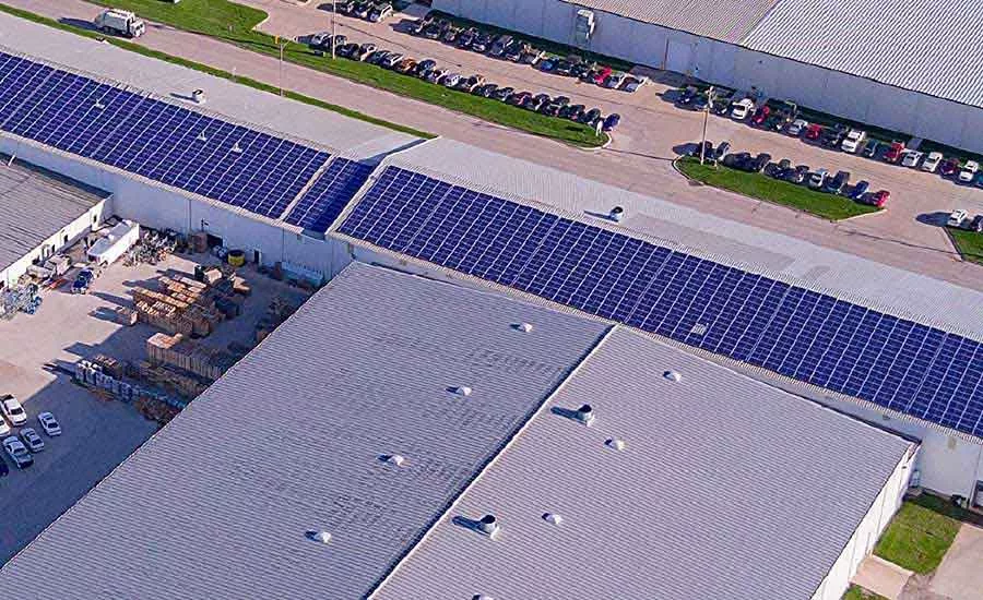

Mounted on the Agri-Industrial Plastics Co. manufacturing facility is a 517-kilowatt solar array. Photo courtesy Agri-Industrial Plastics Co.

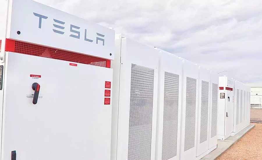

The modular Powerpack energy storage system features 16 lithium-ion battery pods and is durable enough for outdoor use. Photo courtesy Tesla

The AIPC plant features a 517-kilowatt, roof-mounted solar array that works in tandem with a 430-kilowatt-hour energy storage system composed of two battery-powered Tesla Powerpacks. During the day, the solar panels generate energy, which charges the Powerpacks and powers all manufacturing operations.
Schaefer-Weaton says that AIPC’s energy load is fairly consistent over the course of the year, with peak loads in the 2,500 to 3,000 kilowatt range. Weekend loads can drop to as low as 100 kilowatts, though they are higher when the company runs weekend shifts during busy times.
The primary purpose of the Powerpacks is to help AIPC achieve peak shaving with greater efficiency and reliability. AI-based controls ensure this by automatically charging the Powerpack’s 16 lithium-ion battery pods when electricity rates are at their lowest and discharging energy at times of high usage (or peak demand) to avoid or reduce costly demand charges.
Each Powerpack is modular, scalable and durable enough for outdoor use. It is also AC-coupled, rather than DC-coupled, meaning it operates completely independent of the solar array. This ensures that if the array or energy storage system goes down (for whatever reason), the other part of the installation will continue to operate.
