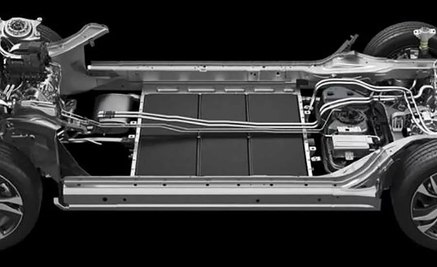

The Five will be built on a skateboard platform that offers multiple trim levels. It will feature a dual-motor configuration that allows all-wheel drive and a top speed electronically limited to 155 mph.

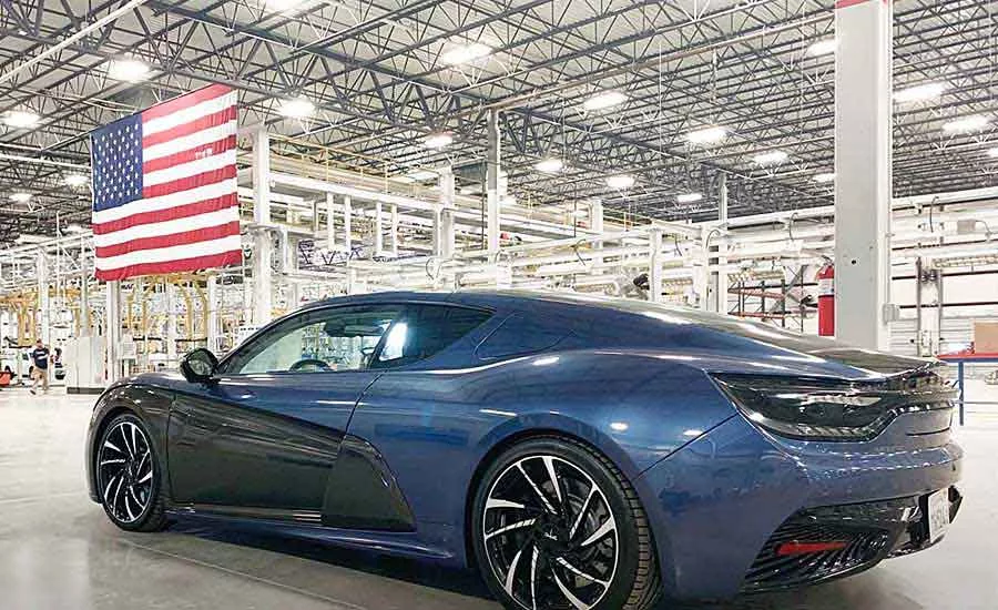

The automaker is currently ramping up production of a cargo van called the Mullen One. It also plans to produce a two-seat model, dubbed the DragonFly, which will feature an all-aluminum body frame and carbon-fiber composite body panels. The sports car will be based on the Qiantu K50, an existing vehicle that's been on sale for several years in China. Future Mullen vehicles will include a seven-seat SUV.

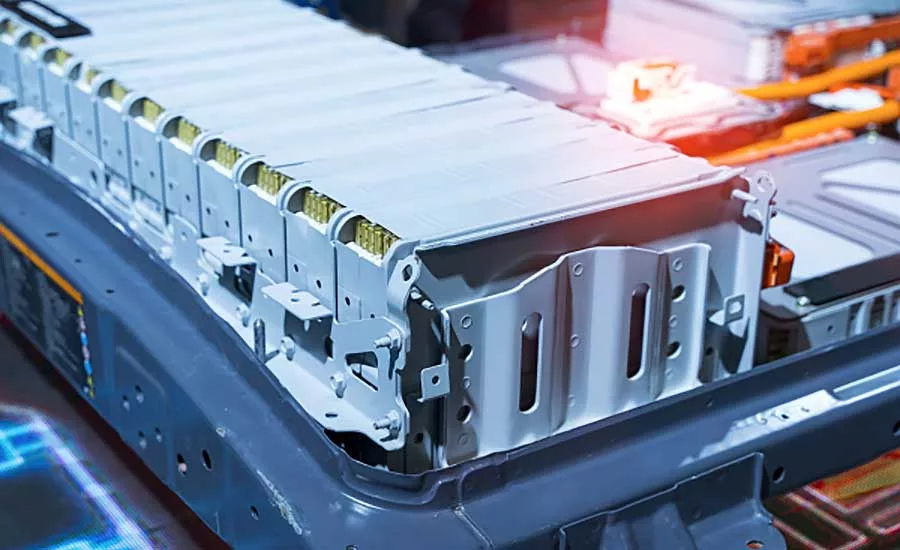

One thing that sets Mullen apart from competitors is its battery technology. Unlike other companies that rely on lithium-ion batteries, Mullen is using a 95-kilowatt-hour lithium-sulfur battery pack that will enable it to achieve a goal of less than $90 per kilowatt hour.
Mullen and its supplier, NexTech Batteries Inc., claim that lithium-sulfur pouch format batteries are 60 percent lighter than lithium-ion. That improves vehicle efficiency and reduces overall energy consumption. It also results in 50 percent lower manufacturing costs.
Although its vehicles are designed in southern California, Mullen’s assembly plant will be located in a different part of the United States. The automaker recently opened an advanced engineering and manufacturing center in Tunica, MS. The 124,000-square-foot facility sits on a 100-acre site that includes a test track.
However, most Mullen vehicles will be assembled at a state-of-the-art factory located 50 miles north in Memphis, TN. The 820,000-square-foot facility is currently being retrofitted with robots and other equipment needed to support large-scale EV production. With the help of local and state incentives from the city of Memphis and the state of Tennessee, Mullen plans to create up to 800 jobs and deliver 100,000 vehicles over a five-year period, commencing in the fourth quarter of 2023.

Michery: The Mullen Five will be the sexiest EV on the market with the most aggressive performance stats. It will be able to accelerate from 0 to 60 mph quickly, while also affording the ability to have long range. The Five will be built on a skateboard platform that offers multiple power train configurations and trim levels in a svelte design. Unlike other EVs, it will use lithium-sulfur batteries.
Lithium-sulfur batteries offer significant weight and cost advantages over lithium-ion. Our high-voltage battery packs are projected to be 60 percent lighter, promise to improve vehicle efficiency and increase range significantly. These more efficient, energy dense and safer batteries will catapult our EV vehicle lineup ahead of any competitor. That’s because sulfur is readily available, more sustainable, safer and a lot less expensive than cobalt and manganese. It is also an extremely safe chemistry; the pouch design is not subject to thermal runway reactions.
