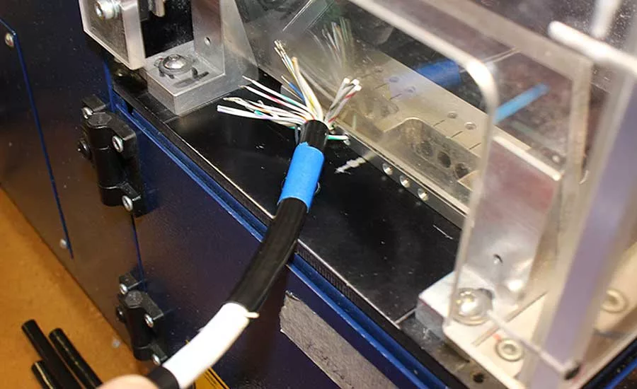

A worker uses the company’s 25-watt dual-axis laser stripper to prep wire conductors prior to assembling a harness for a critical aerospace application. Photo courtesy MJM Industries Inc.

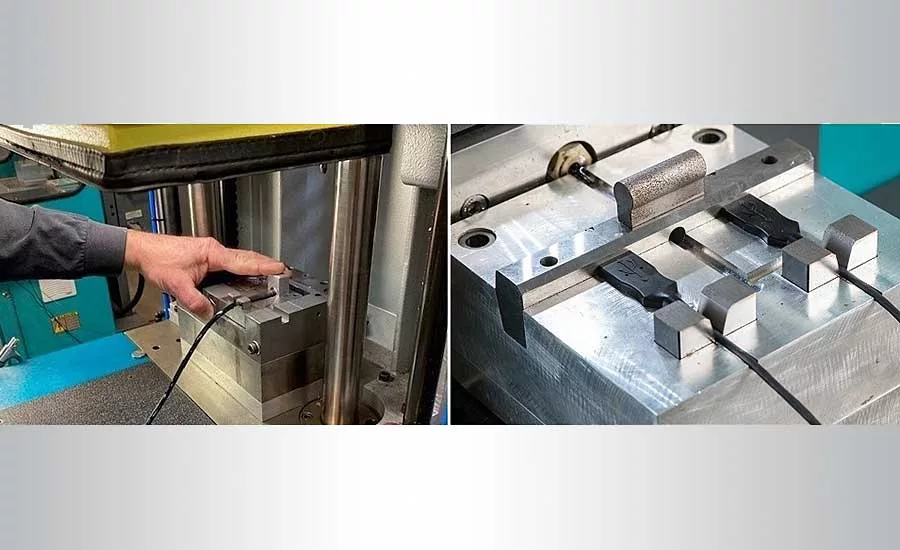

MJM Industries specializes in making custom overmolded wire and cable harnesses. Photos courtesy MJM Industries Inc.

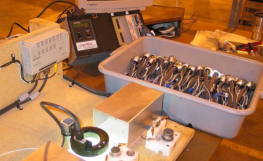

At this workstation, final quality inspection of harnesses with round connectors is performed using a hipot tester. Photo courtesy MJM Industries Inc.

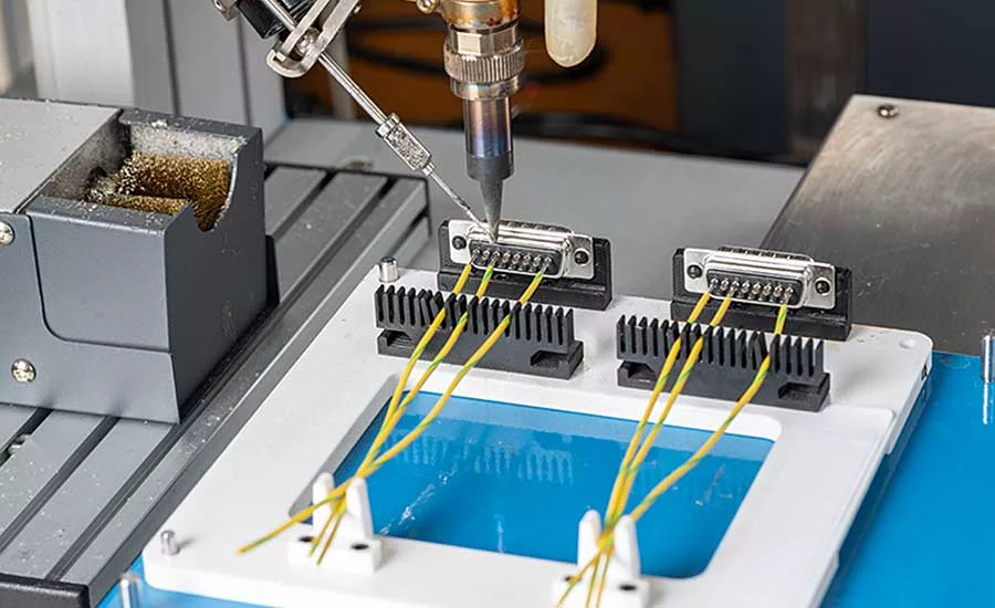

Robotic soldering of conductors to a D-sub connector occurs regularly on the production floor of MJM Industries. A D-sub connector contains two or more parallel rows of pins or sockets usually surrounded by a D-shaped metal shield. Photo courtesy MJM Industries Inc.

At any given moment, harnesses for up to 25 customers are in various stages of assembly. The well-equipped production floor of MJM contains several wire cutting and processing machines, crimping presses on wheels, a laser stripper, robotic soldering and ultrasonic welding units, as well as molding, test and inspection equipment.

The company’s molding capabilities range from auxiliary core pull to vertical inject and vertical platens, with a clamping range of 5 to 35 tons. In addition, MJM is a preferred harness provider for critical aerospace applications. This is due to its 25-watt, dual-axis stripper, which is able to quickly and accurately strip various types of wire insulation.

At the back of the general assembly area, the quality and testing team examines each assembly to make sure it is built properly and of good quality. Each assembly is then tested and inspected prior to packaging. For large international customers, the team produces compliance documentation such as RoHS, REACH and conflict minerals.

Cole: Molding is one of our specialties. We have several machines at our disposal that run materials such as PVC, polyurethane, nylon, liquid crystal polymer and hot melt. Our engineering team designs our own molds, and we have the ability to fabricate steel, aluminum or 3D tooling in house. Admittedly, we do outsource the fabrication of several of our molds because we trust the venders and it frees up engineering to focus on other important tasks. But, we do have the talent and the equipment in-house to do it. We also have something called a Speed Cell for customers that have an assembly that needs to be quickly quoted and built. This has helped us be successful in building new relationships. Finally, our greatest resource is our people, which are such an integral part of our success. During COVID, when materials were not available and production shut down, we kept everyone on the payroll with full benefits, regardless if they were at work or on call at home.
