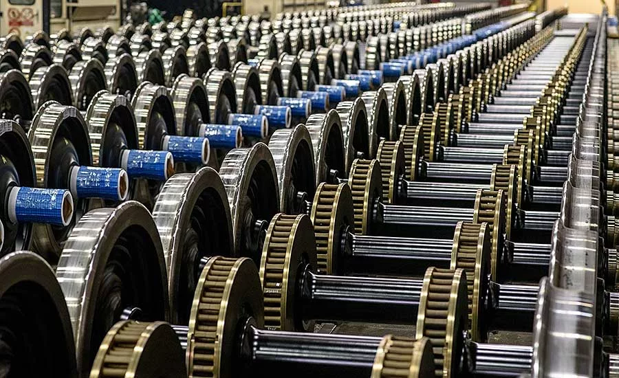

We tend to think of press fit assemblies as being relatively small. For example, a bushing for an automotive control arm assembly is typically less than 2 inches in diameter. But, much larger assemblies can also be accomplished with press fits, too. One example is railcar wheelsets. Railcar wheels are 36 inches in diameter and several inches wide. A wheelset—two wheels connected by an axle—can weigh more than 400 pounds.

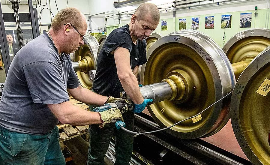

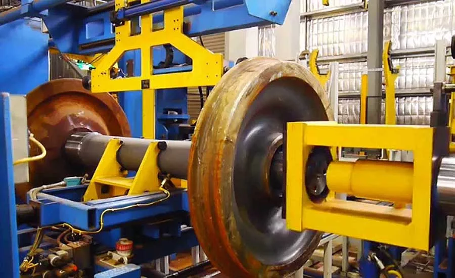

Wheels can be press fit or shrink fit to axles. Also known as a force fit or interference fit, a press fit is an assembly in which one part is inserted tightly into a hole in another part. The assembly stays in place through friction and the force of the two parts pushing against each other. The process is reliable, simple, and does not require heating, cooling or soldering.
But, press fitting assemblies as large as railcar wheelsets takes care. Excessive interference can result in slip between the wheel and axle. Fretting wear can occur at the interface of the axle and wheel hub, and this can cause surface fatigue, adhesion, oxidation, exfoliation and scratching. Peak force limits and the force-displacement curve must be considered.

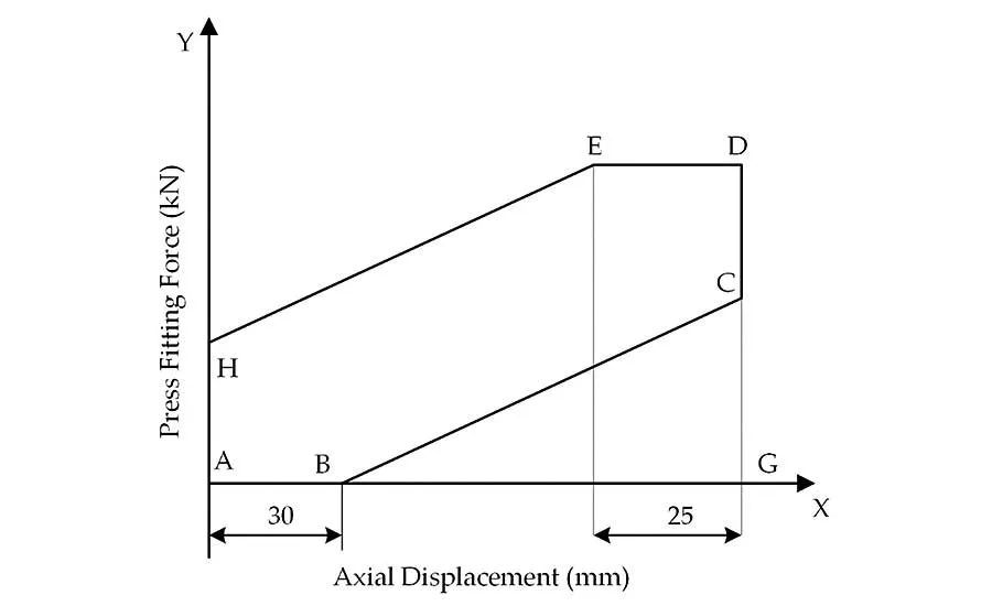

Figure 1 depicts a press fitting curve, showing force vs. displacement. The displacement is the movement of the wheel along the axle, since the axle is fixed to the clamping head of a machine. The standard requires the final fitting force to be between 0.85F and 1.45F. The axial force, F, in kilonewtons, is four times the mean diameter of the axle wheel seat. Axial displacement must be between 0.8d and 1.1d. The lines, AB, BC, HE and ED, define the boundaries of the force-displacement curve. Contact length is the X axis segment, AG. The points on the graph can be found by using the following equations: YH = 1.3ɸ; YC = 0.85F; and YD and YE = 1.45F. ɸ is the nominal diameter of the wheel seat in millimeters.
The press fitting force is related to many factors, including interference, the friction coefficient, and the elasticity of the parts. These factors can significantly change the press fitting force. The press fitting force to the wheel on the axle, Fp, can be calculated from the following equation: Fp = μ∫A  PdA. In this equation, P is contact pressure in newtons per square millimeter; μ is the coefficient of friction, and A is the contact surface area in square millimeters. Thus, to obtain the press fit force, the contact pressure between the two assembly parts must be known.

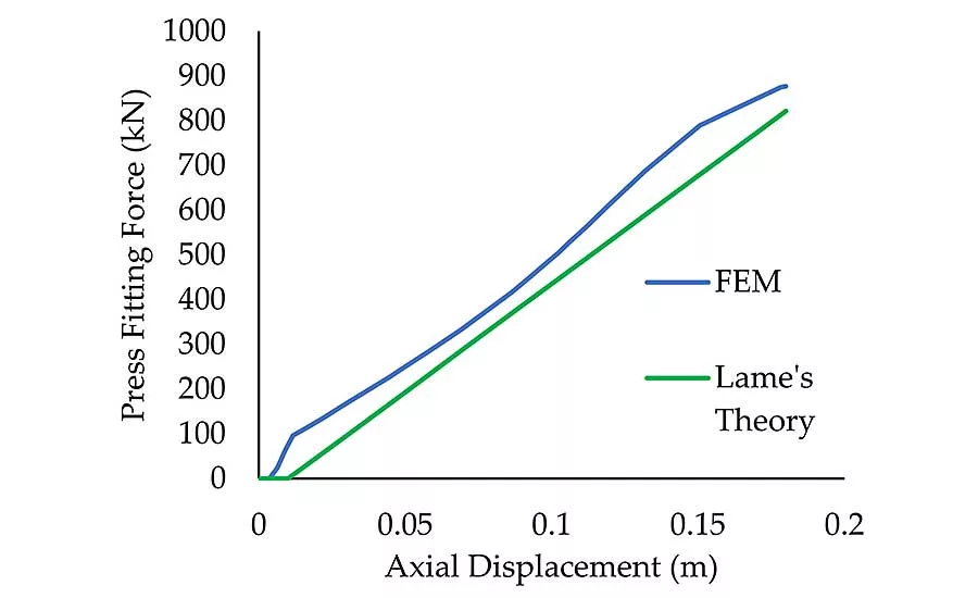

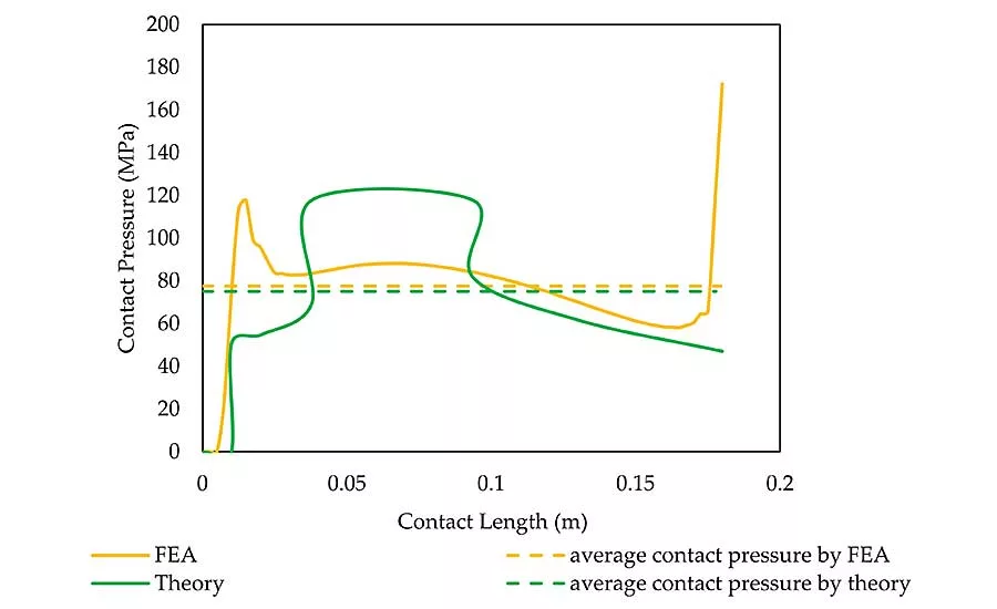

To verify the effectiveness of the numeric model, the finite element results were compared with the calculated theoretical results. The contact pressure between the wheel and axle wheel seat at different sections was determined, and the average contact pressure was calculated. The contact pressure of the axle reached its maximum at the end of the contact edge.
The finite element analyses led to higher average contact pressure than the theoretical model because the volume of the 3D model used in the finite element simulation was greater than that of the theoretical model. The finite element results were 3 percent greater than the theoretical ones. At the start of the wheelset assembly, the two parts did not contact each other because of the taper of the axle. Therefore, the press fitting force and contact pressure were zero until the end of the taper was reached, and then they suddenly increased.
The theory showed that the contact pressure was directly proportional to the outer radius or profile of the wheel and increased in the center of the contact region. The contact pressure of the axle increased sharply at the start of the contact and decreased towards the center of the contact length and maximum at the rear end of the edge.

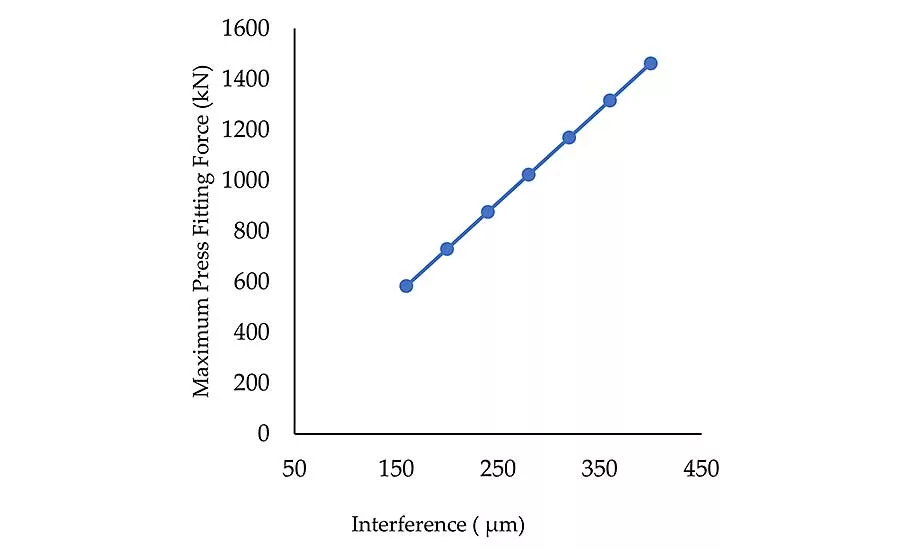

The maximum press fitting force at the end of the assembly was 877 kilonewtons from the finite element analysis and 822 kilonewtons from the theory, when the interference was 240 microns. The 7 percent difference between the results was considered acceptable.
The interference was a significant factor that affected the press fitting curve. Simulations used interferences from 160 to 400 microns. The press fitting force increased, as expected, with the interference. The boundary of the press fitting curve was obtained from the EN 13260 standard.
The press fitting curves were used for monitoring the assembly and evaluating its quality. The curves for interferences of 160, 360, and 400 microns did not qualify because they were outside the EN 13260 boundary. One key conclusion from the simulations was that the interferences, specified by the EN standard, fell within the boundary. When the interference increased by 20 percent, the maximum press fitting force increased by 12 percent.

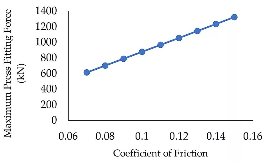

We observed that the friction coefficient affected the press fitting force during the assembly. Friction coefficients in the range 0.08 to 0.13 were the only ones acceptable. In general, the greater the friction coefficient, the greater the maximum press fitting force. Every 0.01 increment in the friction coefficient increased the maximum press fitting force by 14 percent.

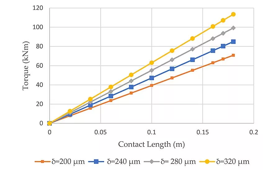

The maximum holding torque capacity, T, is the torque required to prevent slip between the wheel and the axle, as it resists the motion of the wheelset at the contact surface. It is transmitted by frictional forces on the wheelset and can be evaluated using Lame’s equation. It was assumed that the contact pressure in the assembly was uniformly distributed. The radial interference was significant for the holding torque capacity, since it was related to the contact pressure and frictional force. The holding torque capacity of the wheelset, T, was thus a function of the friction coefficient, contact area and contact pressure: Fp = μ D/2 ∫A  PdA.
In this equation, μ is the static coefficient of friction; D is the axle diameter; P is the contact surface pressure; and A is the contact surface area. The holding torque capacity was related to the contact length of the press fit assembly. The maximum holding torque capacities were 71 kilonewton-meters for the interference of 200 microns, 85 kilonewton-meters for 240 microns, 99 kilonewton-meters for 280 microns, and 113 kilonewton-meters for 320 microns. Clearly, the holding torque capacity increased with the interference.
Finite element analysis was used to examine the effect of the interference on the holding torque capacity for the wheel and axle assembly. The geometry of the 3D models and materials properties were similar to those for the press fit analysis. During the holding torque analysis, surface-to-surface contact interaction was set between the wheel and axle interface with a contact interference fit option. A penalty frictional coefficient, 0.1, and hard contact were set as the contact properties.
It was necessary to define the reference points on the axle at both end-sides of the center point. To obtain more accurate results, a refined mesh was used at the contact area with a coarse mesh for the other areas. Torque loading was applied to the reference node at the end of the axle, and the outer surface of the wheel was fixed. The value of the applied torque was increased until rotation or slip occurred in the interface.
The torque capacity analysis simulated the wheel and axle assemblies to obtain the curves of the torque and rotational angle, which determined the maximum holding torque capacity for different interference values. The torque and rotational angle curves were needed to decide the torque required to resist the slip between the interference assemblies.
Within the elastic torque region, the shear stress in the axle varied linearly, and the axle showed only elastic deformation. When the torque increased to the plastic region, the axle rotated continuously with no further increase in the torque. The maximum elastic torque was equal to 75 percent of the maximum holding torque capacity at the fully plastic region. Therefore, it was evident that the maximum holding torque capacity or plastic torque, before slipping, was 75 kilonewton-meters at the twist angle 0.15 radian, and the maximum elastic torque was 56 kilonewton-meters at the twist angle 0.029 radian for the interference of 240 microns.
Elastic torque did not exceed the 75 percent of plastic torque for 240 microns. Other fit lengths were also less than 75 percent of the maximum holding torque capacity.
When the torque increased beyond the maximum holding torque capacity, the axle started slipping. Deviations between the estimated maximum holding torque capacities from the theory and finite element analyses all 15 percent or less.. Thus, the finite element results agreed with the theory.
