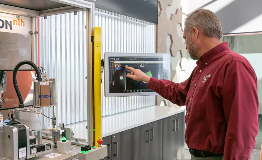

For Automationnth, Epson was a natural choice to meet the all needs of this assembly system. An Epson customer since 2017 and a member of Epson’s AutomateElite authorized system integrator program, Automationnth knew the robot maker offered a wide range of products for small-parts assembly.
“A particular application that we developed for this customer required super high precision. We were looking for a robot that had ultra-high precision capabilities,” says Buck. “We found the Epson G-Series, and that’s why we picked Epson.”
Epson G-Series SCARA robots feature a high-rigidity arm design that delivers high speed, high precision and low vibration. The line-up offers a maximum reach of 175 to 1,000 millimeters and a maximum payload of 1 to 20 kilograms. The robot can perform a standard pick-and-place move—1 inch up, 12 inches across and 1 inch down—in just 0.29 second.
“With the G-Series, we were able to provide vision feedback to provide offset settings back to the robot,” says Buck. “This helped us establish an industry standard by which Epson robots are now widely used across many key life sciences manufacturers.”

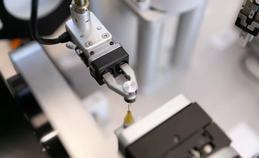

For this particular application, the final product was the size a quarter. Its individual components were very small, indeed. The parts had insertion tolerances of 20 microns in the X and Y axes and 1.5 degrees of angular rotation. The robot would need to move with an accuracy of ±5 microns. Automationnth created a parts feeding system that used Epson G-Series robots to identify and handle different components that were barely visible to the human eye.
The company also employed its Flexbase configurable, modular platform for automation. Flexbase enables manufacturers to standardize production equipment, simplify engineering and maintenance, and adapt quickly to changing production requirements. It also provides a lower-risk path to transition manual processes to semiautomatic or fully automated processes. Flexbase can be used for a variety of processes including assembly, sorting, testing, handling, fastening and joining.
Available in standard 4- or 6-foot-wide models, Flexbase can be configured as a standalone automated workstation or linked together to quickly create a complete production line. Optional conveyors can be configured with over-under pallet recirculation.
Flexbase is ISO 6 compliant and can be FDA validated with a documentation package. It has a maximum height of 7 feet, 6 inches to fit through a standard 8-foot doorway and includes built-in levelers. It is also ergonomically designed to accommodate a standing or sitting operator.
For this assembly, Automationnth needed to pick up components from various feeding systems, including a reel, a feeder bay and a tray with an escapement. The parts would then be inserted into the assembly, explains Buck.

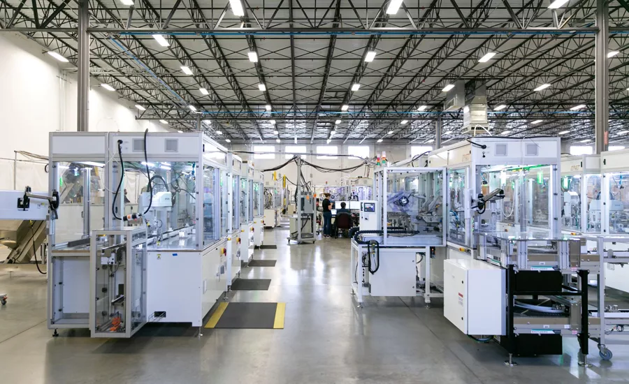

Using a variety of automation equipment enabled Automationnth engineers to deliver the best combination of functionality and price.
“For the scope of this program, we were able to easily install a range of Epson robots—18 from the G-Series and 21 from the T-Series for each line. With six lines altogether, that’s 234 robots,” shares Young.
Programming all those robots could have been a chore, but Epson’s user-friendly RC+ programming environment made the job easy. The software allows all components to communicate on a single platform. “It allowed us to interface with the Epson robots using a template code that that we developed,” says Buck.
Ultimately, the medical device manufacturer was pleased with the automated production line, which provided better quality and faster cycle time than manual assembly.
“Our customer is very happy because they were able to successfully execute one of the fastest production ramps the industry has seen,” says Young. “They are now producing millions of units per year, while also improving their yield and product quality. This also resulted in less product warranty exposure.”
