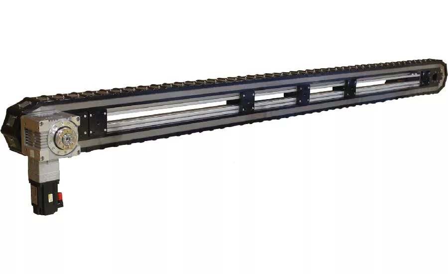

LFA precision indexing conveyors ready to accept robot auxiliary axis motors.

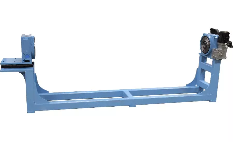

Precision Indexer mounted in trunnion configuration with Motoman auxiliary axis motor.

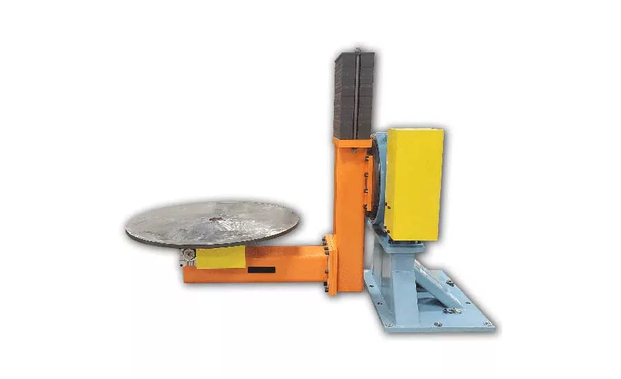

This sky hook device uses programmable indexers providing additional axis to a Fanuc welding robot.

The possibilities don’t stop at the rotary index table.  Motion Index Drives has a line of precision indexing conveyors that are offered as fully programmable linear indexing systems.  Our precision indexing conveyors are used in automated processes that are layout in a linear fashion and required very high accuracy.  They have an overall accuracy in X, Y, Z direction of +/- 0.06 mm.  Traditionally these systems were operated with a fixed cam indexer.  In recent years there has been more demand for flexibility without compromising the accuracy of the system.  As with the rotary index tables more customer in the past few years have requested precision indexing conveyors that would be ready to accept robot servo motors.
