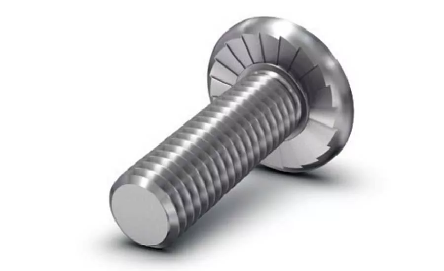

The ecosyn-grip bolt features a recess at the transition of the shaft to the head. Photo courtesy Bossard AG

The key to the ecosyn-grip bolt’s effectiveness is its unique design. Instead of having a washer, the bolt features a recess at the transition of the shaft to the head. This design increases load-bearing capacity and reduces the risk of the bolt loosening and falling out.
