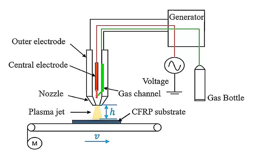

This diagram shows the setup for plasma treatment of the CFRP coupons. The key parameters of the process are nozzle height, h, and nozzle velocity, v. Illustration courtesy Tongji University

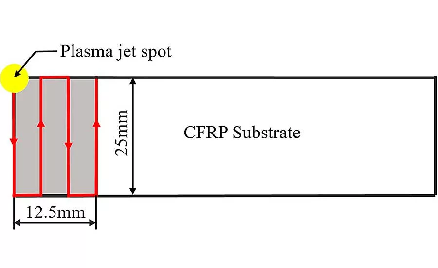

Plasma treatment was applied to an area 14 millimeters wide and 25 millimeters long, or slightly larger than the bond area, which measured 12.4 millimeters wide and 25 millimeters long. Illustration courtesy Tongji University
The test coupons measured 100 millimeters long and 25 millimeters wide. The bonding area is 12.5 millimeters long. Illustration courtesy Tongji University

The plasma treatment system operated at a frequency of 12 kilohertz and a voltage of 8 kilovolts. The plasma was jetted to the surface through a circular nozzle 4 millimeters in diameter. Air was used as the plasma gas, and gas flow was set to 30 liters per minute.
The speed of the nozzle varied. Five speeds were tested: 1, 3, 5, 7 and 10 millimeters per second.
The distance between the nozzle and substrate also varied. Five distances were tested: 10, 14, 18, 22 and 26 millimeters.

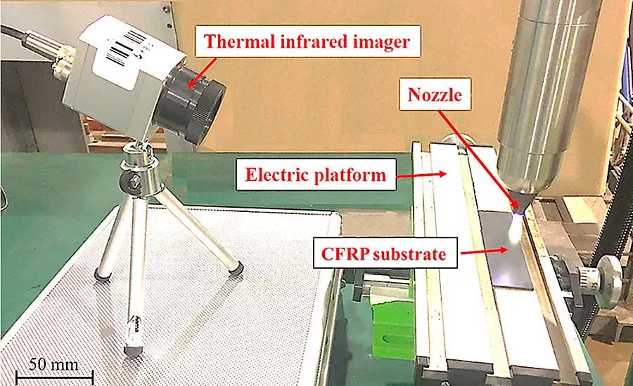

A thermal infrared imager was used to measure substrate surface temperature during plasma treatment.

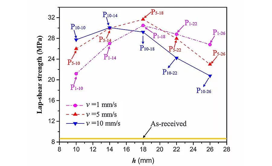

The lap-shear strength of bonded joints made from untreated CFRP was only 8.6 megapascals (MPa).
Among plasma-treated samples, lap-shear strength varied depending on the speed and position of the nozzle over the substrate during treatment. For example, when nozzle speed was 1 millimeter per second, lap-shear strength increased from 21.2 to 30.5 MPa as nozzle height increased from 10 to 18 millimeters. As nozzle height increased beyond 18 millimeters, lap-shear strength decreased nearly linearly.
A similar pattern was observed at faster nozzle speeds. For example, at 5 millimeters per second, lap-shear strength reached a peak value of 31.6 MPa at a nozzle height of 18 millimeters. At 10 millimeters per second, lap-shear strength increased from 27.7 to 29.7 MPa as nozzle height increased from 10 to 14 millimeters, then decreased continuously with further increases in height.

Lap-shear strength in the case of cohesive failure was higher than that for substrate failure, which may be due to thermal damage to the CFRP from the plasma when nozzle height was too low and nozzle speed was too slow.
To understand how plasma heats the substrate, we measured the surface temperature during treatment. Not surprisingly, the highest surface temperature was recorded at the shortest nozzle height and slowest nozzle speed.
Our tests found that nozzle height was more important than nozzle speed for heating the substrate. For example, when nozzle speed was 1 millimeter per second, the surface temperature decreased from 538 C to 132 C as nozzle height increased from 10 to 26 millimeters. When nozzle height was 10 millimeters, the temperature decreased from 538 C to 437 C as the nozzle speed increased from 1 to 10 millimeters per second.
The latter effect became less significant as nozzle height increased. For example, when nozzle height was 26 millimeters, the temperature decreased by only 30 C as the nozzle speed increased from 1 to 10 millimeters per second.
