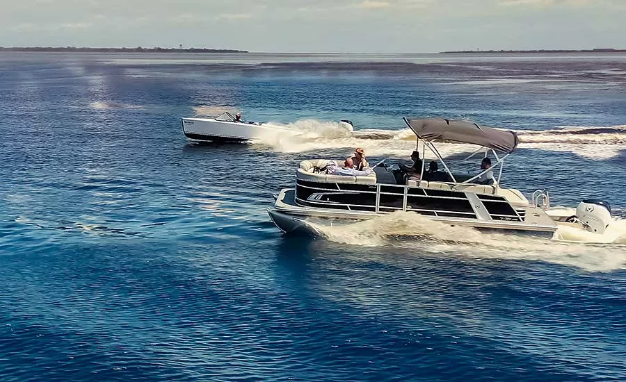

This 24-foot pontoon boat is equipped with two electric motors. Photo courtesy Pure Watercraft

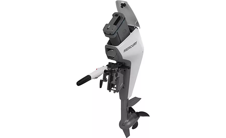

For decades, Mercury Marine engines have been the go-to source of power for generations of boat owners. The 83-year-old company, which traces its roots to a small machine shop in Wisconsin, has been focusing recent R&D efforts on electric power. Earlier this year, Mercury unveiled the Avator electric outboard engine at the Miami International Boat Show.
It is designed for use with a wide range of pleasure craft, including dinghies, fishing boats and pontoons. Mercury plans to bring the portable electric outboard to market next year, following in the wake of other manufacturers, such as ePropulsion, Torqeedo and Vision Marine Technologies.
“Electrification is strategically important to us, and this concept provides a first look at how we intend to deliver on our commitment to being the industry leader in both internal combustion products and electric propulsion,” says Chris Drees, president of Mercury Marine, a division of Brunswick Corp. “We are taking efficiency to a new level, opening up new ways to enjoy the boating experience.”
“We see growing demand for electric outboards, especially in the low horsepower segment, where the benefits of electric can be realized at competitive prices,” adds Alex Cattelan, chief technology officer at Brunswick. “As the leader in recreational marine propulsion, electrification is strategically important.
“Electric propulsion provides unique performance, including quiet and smooth operation, zero direct emissions and ease of maintenance,” notes Cattelan. “We are developing the Avator concept to take full advantage of these benefits while efficiently managing on-board battery energy.”
According to Cattelan, there are many similarities in the design and assembly of ICE and electric outboards. Mercury Marine also plans to leverage its long-standing knowledge of compact packaging and intuitive operations.
“For the Avator concept, we also integrated unique display, communication and connectivity [features] we expect to appeal to our customers,” says Cattelan. “On the manufacturing side, commonality includes efficient and repeatable processes with precise measurement and controls.

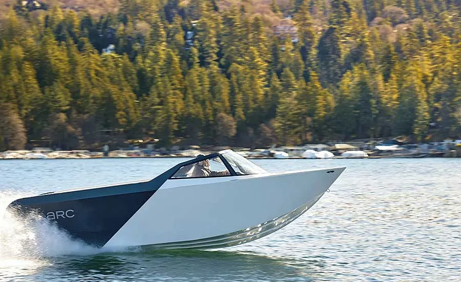

Arc Boat Co., a Los Angeles-based startup founded last year by a group of former SpaceX engineers, is planning to deliver a handful of limited-edition battery powered, aluminum hulled boats boasting a top speed of 40 mph. Its 24-foot Arc One will cost more than $300,000. But, the company claims that it will be “far more reliable, cheaper to operate and maintain, quieter, quicker and more seamlessly integrated with software than any gas boat.”
Arc designs and builds its speedboats in-house, including battery packs, power train systems, thermal control systems and software.
A fast craft like the Arc One requires a large battery. With 220-kWh, the battery, which weighs nearly 3,000 pounds, offers three times the capacity of a Tesla Model Y—at nearly three times the size. The company estimates that it will supply enough energy for three to five hours of use. The battery’s weight is used to establish a low center of gravity for the boat and provide a smooth, stable ride.
“The design of the boat and the battery have been heavily intertwined from the very earliest design stages,” says Ted Herringshaw, head of product at Arc Boats. “This is one of the benefits of our approach to building for electricity from the beginning, as opposed to retrofitting a gas boat.”
Boats need more energy than cars do, since they constantly encounter resistance while moving through the water. However, cooling, which is one the biggest challenges with electric vehicles, is easier when you can use the surrounding water. Charging patterns are also friendlier for boats—closer to the way one would use a phone rather than a car.
“A boater typically goes out for one long session, followed by one long overnight rest at a familiar location,” explains Herringshaw. “In a car, you'll mix in more starts and stops in different locations throughout a day, along with longer road trips.”
Another major concern is waterproofing. Herringshaw says all Arc battery packs and electrical systems are watertight, heavily reinforced and constantly monitored. “Luckily, we’re not the first ones that needed to solve this problem,” he points out, noting that electric cars also operate in volatile, wet environments. “There’s some prior learning we can build on in this area.”
