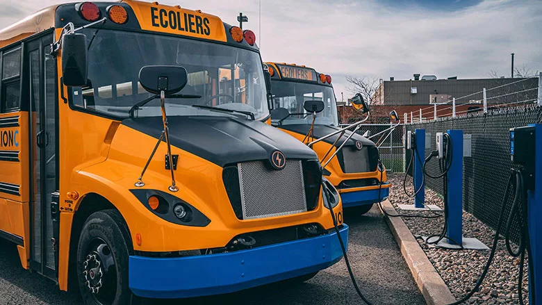

electric bus
Battery-powered buses reduce emissions and improve energy efficiency. Photo by Austin Weber
