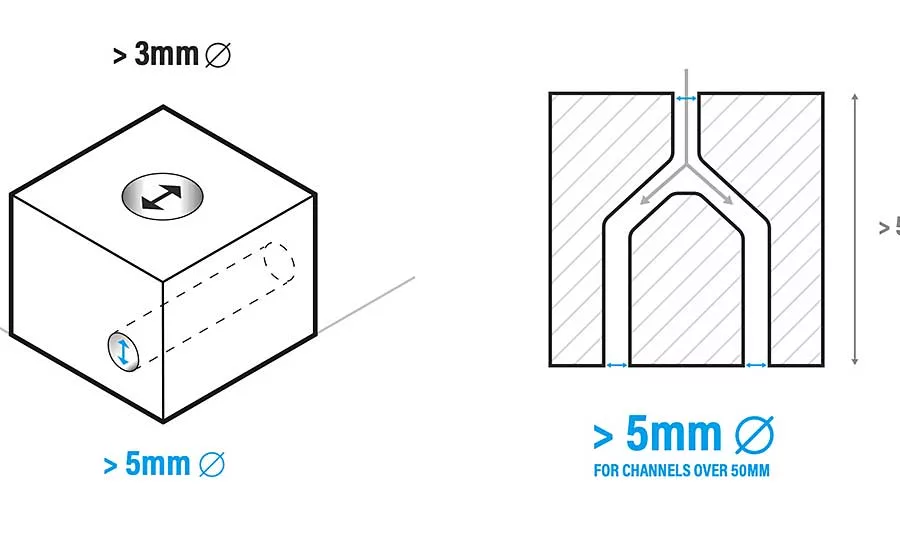

Powder can fuse into holes and channels with small diameters. To prevent this, we recommend a minimum diameter of 3 millimeters. Photo courtesy 3DPRINTUK

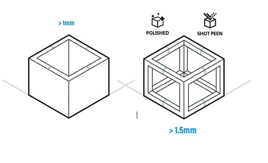

Our guaranteed minimum wall thickness for unfinished parts is 1 millimeter. For parts that will be polished or shot-peened, our guaranteed minimum thickness is 1.5 millimeters. Photo courtesy 3DPRINTUK

WALL THICKNESS
Wall thickness is a critical consideration for parts being designed for AM, both in terms of the part itself and any post-processing that may be required. Our maximum recommended wall thickness will prevent shrinkage deformation during cooling, while our minimum recommended wall thickness will ensure parts withstand automated post-processing techniques without damage.
Our guaranteed minimum wall thickness for unfinished parts is 1 millimeter, but there are exceptions when this thickness should be increased. Exceptions include vulnerable unsupported structures, skeletal structures, weight-bearing walls, and specific performance requirements.
For parts that will be polished or shot-peened, our guaranteed minimum thickness is 1.5 millimeters. Again, there are exceptions for vulnerable unsupported features, weight-bearing walls and performance requirements.
Our recommended maximum wall thickness is 5 millimeters. Anything beyond 10 millimeters may require the wall of the part to be hollowed out to prevent shrinkage deformation, build failures and excessive print times.
In most cases, a 3-millimeter wall thickness provides a rigid part with a little or no flex, while a 1.5-millimeter wall thickness results in some flex, depending on length and structural support.

HOLES AND CHANNELS
One of the key advantages of AM is the ability to design and produce complex geometries without the need for expensive tooling. However, designers still have to be mindful of the complexities they design-in to parts, especially when it comes to holes and channels running through the part. The nature of PBF processes comes into play here—specifically the amount of heat that parts are exposed to during the build process. Thus, powder can fuse into holes and channels with small diameters. To prevent this, we recommend to design them greater than 3 millimeters.
For internal channels over 50 millimeters long, the same problem applies. It can be difficult to remove all of the powder. We recommend a diameter greater than 5 millimeters for internal channels. The same rule applies to curved holes, too.
