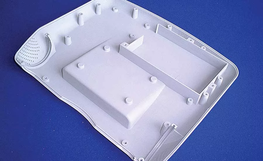

Design for Additive Manufacturing
In injection molding, a draft in the outer surface of a boss facilitates easy removal of the parts from the core and cavity of the mold. In additive manufacturing, such drafts serve as stiffeners. Photo courtesy Geometric Ltd.

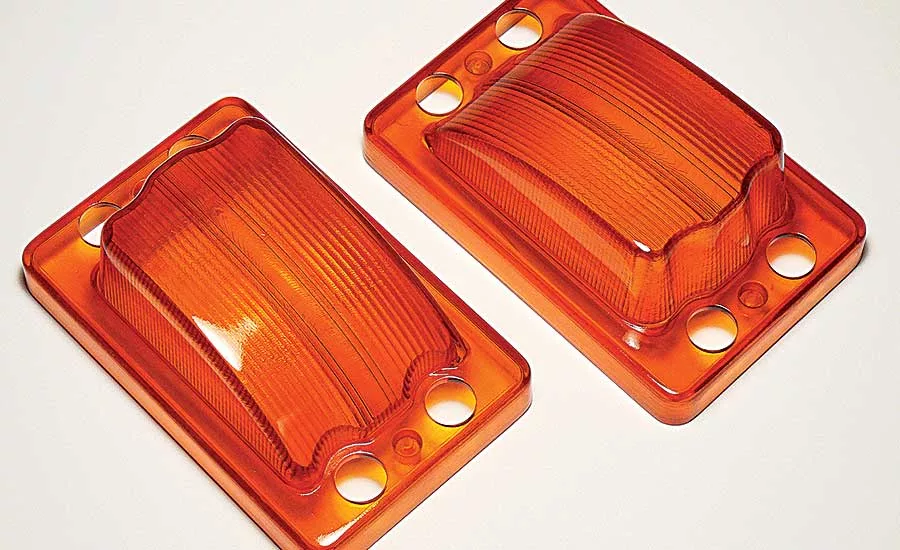

These translucent parts were made with stereolithography. Features such as overhangs and undercuts require support when created using this method. Photo courtesy Additive Manufacturing LLC

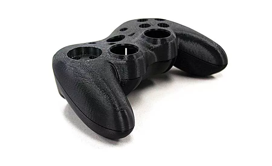

This prototype game controller was created using fused deposition modeling. Photo courtesy Forge Labs

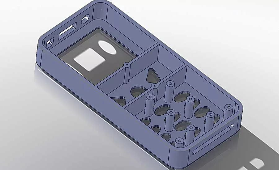

Boss Design
Part designs may have bosses, which serve as points for attachment and assembly. The most common boss designs consist of cylindrical projections with or without holes. Holes in bosses are designed to receive screws, threaded inserts or other fastening hardware. Under service conditions, bosses are often subjected to stresses not encountered in other sections of a component. So, bosses are generally designed with a draft to increase the strength at the bottom.
In injection molding, drafts in the outer surface of a boss also facilitate easy removal of the parts from the core and cavity of the mold. In additive manufacturing, such drafts serve as stiffeners. A fillet of a certain radius should also be provided at the base of boss to reduce stress. The radius at the base of the boss should be larger than a certain minimum value, depending on the additive manufacturing machine. Tall and slender bosses should be avoided. When designing bosses, correct proportions of height, outer radius, hole radius and hole depth should be observed to achieve the required strength.

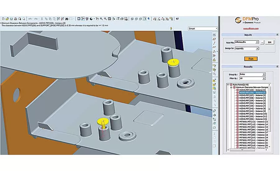

Geometric DFX
Although these design rules for additive manufacturing might appear simple, verifying all these rules manually in 3D models can be difficult and time-consuming. Manual verification can be prone to errors. There’s always the chance of missing a few checks. An automated system can help speed up the process and provide a standard way of verifying parts to avoid manufacturability issues.
Geometric DFX is design-for-manufacturing software that takes 3D parts as input and automatically analyzes all the manufacturability issues based on predefined rules. DFX highlights the rule failures directly in the 3D model and also generates xml and xl reports. The rules are configurable based on the machine and the type of additive manufacturing method. The software can handle a variety of CAD formats, including Pro/Engineer, NX, CATIA, SolidWorks, Inventor, STEP, IGES, Parasolid and ACIS.
By letting DFX check their models for additive manufacturing design rules, engineers can reduce multiple design
iterations and ensure that optimal designs are submitted for manufacturing. DFX helps lower manufacturing costs by decreasing design-to-manufacturing lead time and reducing the number of trial runs.
DFX software covers more than just additive manufacturing. The software includes modules with similar design-rule checks for other manufacturing processes, such as milling, turning, sheet metal processing, injection molding, casting and assembly.
