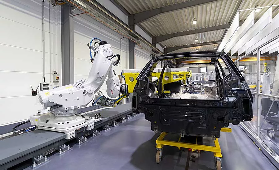

Automakers have an opportunity to rethink many established assembly processes to optimize EV production. Photo courtesy ABB Robotics

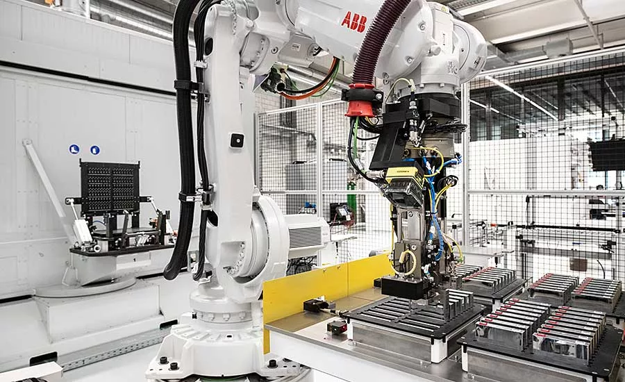

Robots are used on many battery assembly lines. Photo courtesy ABB Robotics

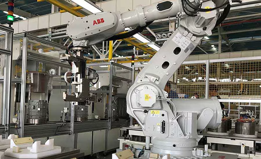

This six-axis robot is loading an electric motor stator into a press station. Photo courtesy ABB Robotics

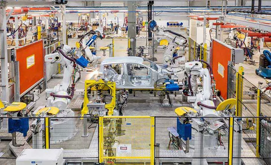

By taking a flexible approach to vehicle manufacturing, OEMs can start small and ramp up as EV demand increases. Photo courtesy VinFast LLC

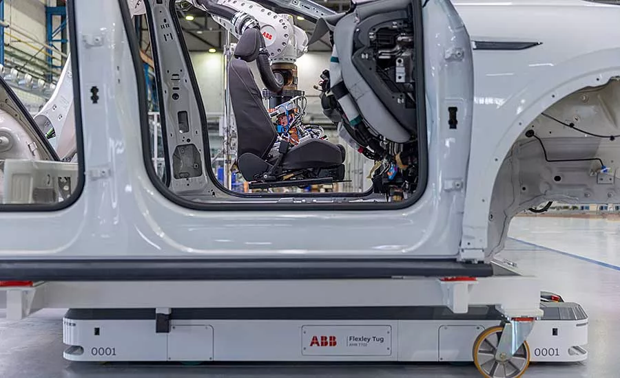

Autonomous mobile robots enable automakers to unravel traditional production architectures and deploy dedicated modular cells. Photo courtesy ABB Robotics

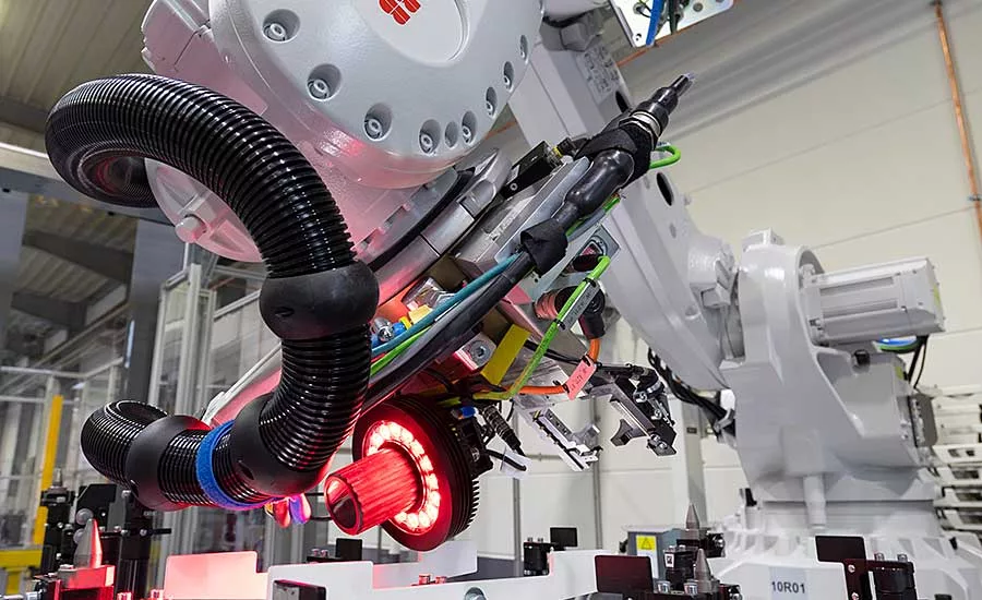

Vision inspection technology enables robots to address a variety of quality issues. Photo courtesy ABB Robotics

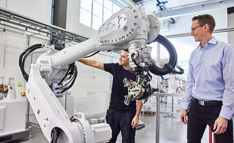

This new six-axis robot is designed to handle heavier payloads associated with EV battery production applications. Photo courtesy ABB Robotics

Solving this conundrum demands unprecedented flexibility. By taking a flexible approach to vehicle manufacturing, OEMs can start small and ramp up as EV demand increases. Key to this approach has been the adoption of automated guided vehicles (AGVs) and autonomous mobile robots (AMRs).
While AGVs tend to follow predefined routes, AMRs are capable of intelligently navigating within their space, avoiding obstacles and even optimizing their journey. They enable automakers to unravel traditional long-line production architectures and deploy dedicated modular cells—arranged alongside the main assembly line like leaves on a branch. AMRs allow engineers to easily modify or add cells without incurring costly interruptions to production.
This zero-loss production methodology has allowed OEMs to adapt and scale up the assembly process by adding or even redeploying workstations as demands change. Gone is the traditional two-week shutdown to allow lines to be reconfigured with each model year.
Changes can now be made almost on the fly, and without the need for the huge capital expenditure that comes from wholesale layout changes. And, with cellular manufacturing, robots can be redeployed in a “lift and shift” process that gives life to an asset beyond its original purpose.

Electric vehicles may use fewer parts overall, but those parts tend to be heavier than their ICE equivalents. Gas tanks have been replaced by batteries, while electric motors with rotors and stators are replacing engine blocks, pistons and cylinder heads. Complex transmissions are being replaced by much simpler gearboxes.
This is changing well-known and well-defined manufacturing processes, and driving both suppliers and OEMs to rethink their automation systems. Robots will be a key driver in this transformation, with many typical use cases calling for high payload and extended reach, a challenging process for the typical automotive six-axis robot.
As well as weight and reach, the EV industry demands speed. Because of advances in control software, we’ve been able to increase the speed robots can operate at, without sacrificing accuracy.
Even when manipulating heavy payloads at maximum extension, fine control can be preserved. This has allowed a new generation of more powerful six-axis robots to replace long, winding conveyor routes to transport vehicle bodies within a far more compact footprint than before, saving space and time, and creating flexibility.
Recent improvements in vision systems have opened the door to a range of exciting new developments that are already helping to drive even greater levels of efficiency in manufacturing. We know from even the earliest automotive assembly lines pioneered by Henry Ford and Charles Sorensen that production can operate much faster if the need to stop is removed from each process.
Although on the face of it modern car production appears as a continuously moving stream, in reality, at key points in the cycle the vehicle must stop to receive a key component or undergo a critical process, such as the installation of the pre-assembled power train.
With vision- and force control-enabled robots interacting with AGVs, it’s now possible to install components such as underbody battery packs while the vehicle is still in motion, with the moving platform matching its speed to that of the suspended body while on-board cameras detect and synchronize with critical mounting points.
This moving-line approach isn’t just faster. With the requirement to stop removed, floor-mounted shock pins are no longer needed. That increases flexibility that can ripple throughout the factory, and makes assembly lines less model specific, making it possible to use the same line or production cell for a variety of different models. That, in turn, leads to a smaller overall factory footprint, as well as significantly reduced capital expenditure.

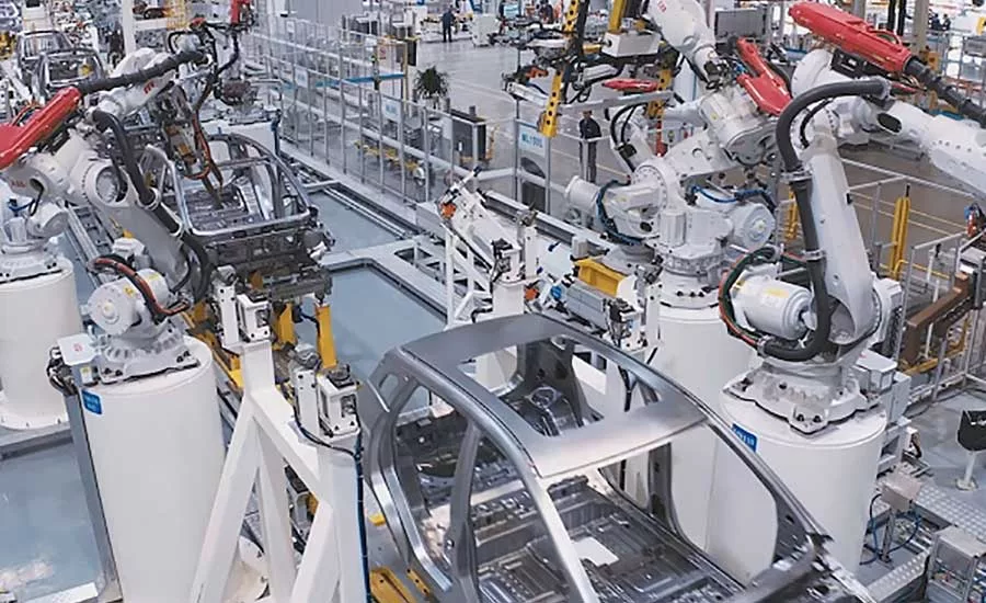

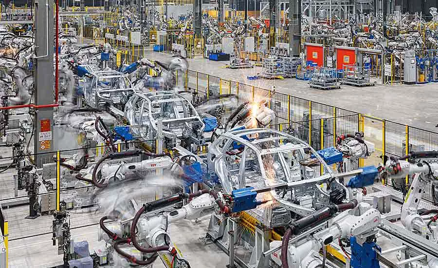

Vision systems are also improving the speed and quality of welding operations. When coupled with advanced artificial intelligence and machine learning systems, their ability to spot minute defects can now match or even surpass experienced human operators. Using models trained on millions of examples, these automated systems can automatically assess the quality of a weld in a fraction of a second just by analyzing a few rapid-fire photographs.
