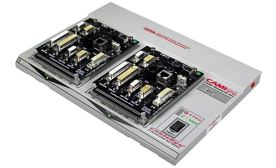

This entry-level tester provides basic continuity measurement in small wire harnesses. Photo courtesy CAMI Research Inc.

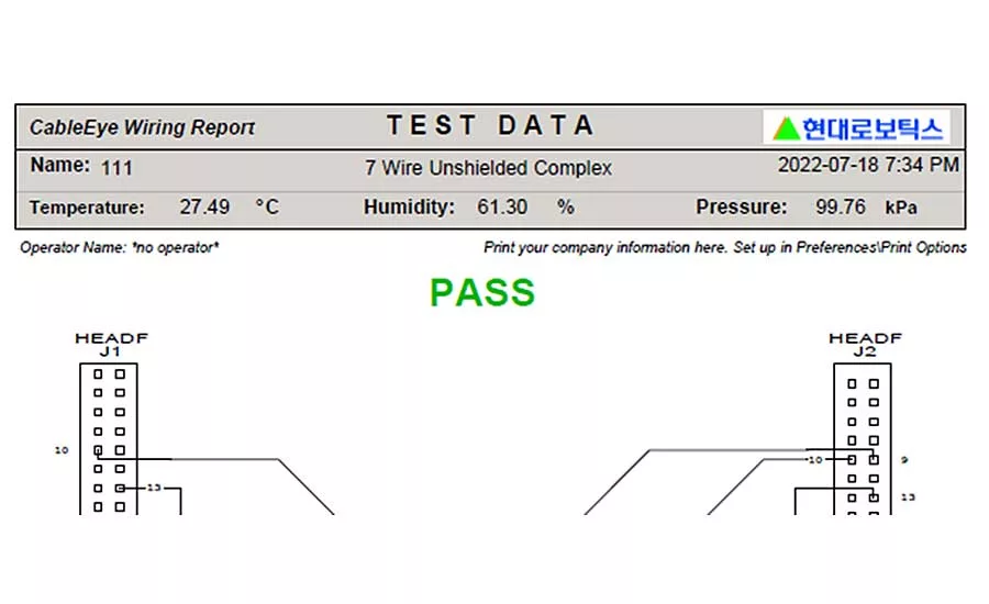

Automatic measurement and reporting of environmental test conditions is provided by this new product. Illustration courtesy CAMI Research Inc.

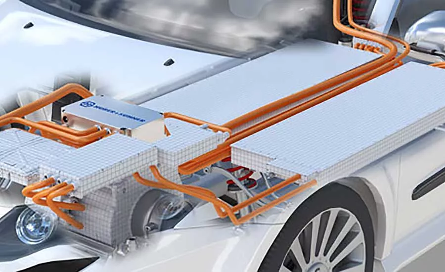

Electric vehicle applications are driving the need for higher test voltages than have historically been required. Illustration courtesy Huber+Suhner

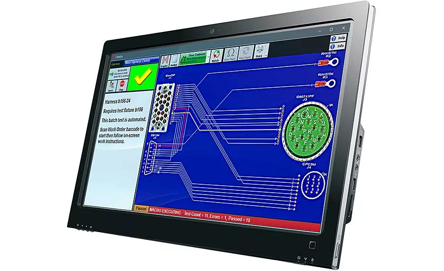

New products now make it easier to test wiring harnesses than in the past. Photo courtesy CAMI Research Inc.

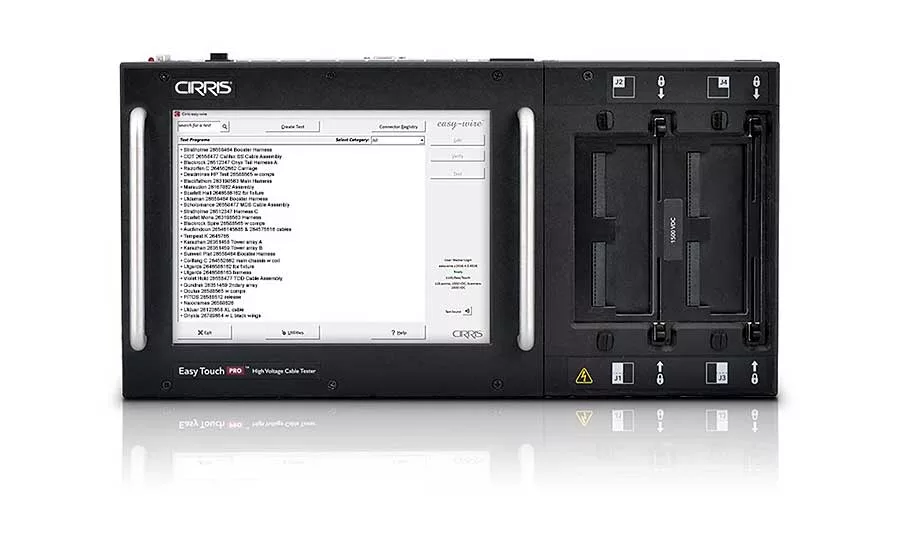

This self-contained high-voltage cable tester is designed for easy integration within production processes. Photo courtesy Cirris Inc.

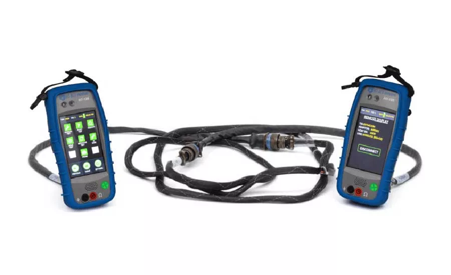

This handheld unit designed for benchtop testing can analyze 128 continuity points. Photo courtesy DIT-MCO International

“As with all of our models, when prepopulated and preconfigured test interface boards are used, the software automatically displays a graphic of the connectors, in addition to the wiring under test,” notes Bishop. “The tester can be readily programmed to do the same for custom boards and fixtures.

“We’re seeing increased interest to integrate our testers with other equipment and to share test data with company information systems,” says Kevin Shelley, product manager at Cirris Inc., a leading supplier of wire harness testing equipment that was recently acquired by the Schleuniger Group.
“Interconnect assemblies are becoming more complex, and with that trend, there’s a need to test more complex assemblies and components,” explains Shelley. “[In addition], the pressure for improved productivity is pushing companies to automate test processes when production quantities justify the investment.
“We’re seeing more demand for test results data, both to document tests and for analysis,” Shelley points out. “We’ve responded to this need with new software and hardware connectivity functionality.
“We are also seeing more demand to test at higher voltages, not just in the automotive market, but for other electric vehicles, plus in-flight and mass transit applications,” says Shelley.
Increasing demand for electric vehicles is driving the need to test high-voltage cable and wire harnesses in the automotive industry, because electrical systems are responsible for a variety of starting, driving, charging and discharging functions.
Cable and wire harnesses are used to connect charging ports to batteries and to connect batteries to traction motors and other drivetrain components. To ensure that only accurate and fully-functional harnesses are installed in vehicles, cables and wires must be tested for continuity, insulation and electrical strength.
“Electric vehicle applications are pushing the need for higher test voltages than have historically been required,” claims Shelley. “There has always been a segment of the market that needs the capability to test at voltages above 2,000 volts DC or 1,000 volts AC, but the EV [trend] has drastically increased this need. These applications require unique, high-volume adapters for testing both physical and electrical characteristics.
“As a member of the Komax family of companies, Cirris has been able to leverage the experience and capabilities of our sister companies to produce and support equipment that meets higher voltage requirements and fulfills the need for EV test adapters,” says Shelley. “To support the high production volumes of the automotive industry, we’ve also been able to combine our test capabilities with the wire processing and integration capabilities of our team members.”

Engineers can choose a variety of innovative products that now make it easier than ever to test cable and wire harnesses. For instance, CAMI recently released an environmental sensor option incorporating the Dracal PTH200 sensor.
“Of particular interest to medical and defense applications, this option provides automatic measurement and reporting of environmental test conditions (temperature, relative humidity and pressure) alongside electrical function data for the cable, harness or backplane under test,” says Bishop. “This option simplifies test and reporting procedures, especially involving testing with environmental chambers.”
“When prepopulated and preconfigured boards are used, the software automatically displays a graphic of the connectors, in addition to the wiring under test,” explains Bishop. “The tester can be readily programmed to do the same for custom boards and fixtures.”
At the 2022 Electrical Wire Processing Technology Expo in Milwaukee, CAMI unveiled the M2Z low-voltage test system. In addition to checking for opens, shorts and miswires, the entry-level tester checks for intermittent faults and diode orientation. The control module has 128 test points and includes a probe socket with probe.
“The M2Z ships with comprehensive, automation-ready software that allows for tester management, troubleshooting, pass-fail testing, and testing of any product volume and mix from prototyping through to batch testing,” claims Bishop. “It is suitable for cables carrying digital signals or any electronic signaling where small amounts of resistance in the cable or connections will not affect the function of equipment to which the cables are connected.”
DIT-MCO International recently launched the HT-128, a rugged, handheld unit designed for product development, benchtop testing and field support applications. The device can communicate with 128 test points and provide remote analysis.
“It enables end users to test installed cables without shorting plugs or long loop-back adapter cables,” says Stringham. “The HT-128 performs continuity and resistance diagnostics for each wire in a harness. Faults such as opens, shorts, crossed wires or high resistance are reported to the user within seconds.
“The system allows you to connect individual testers to each wire harness branch connector rather than relying on a single, centralized tester and multiple return adapter cables,” explains Stringham. “This distributed approach allows you to use small, battery-operated testers that wirelessly link together to achieve the desired wire harness test coverage.”
