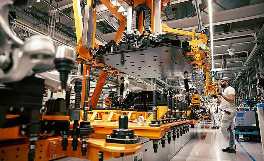

Automakers have an insatiable appetite for lithium-ion batteries. Photo courtesy Audi AG

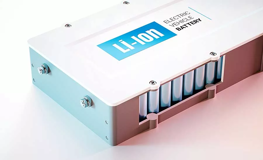

As more electric vehicles are produced, demand for batteries will grow at least 30 percent annually. Photo courtesy IEEE

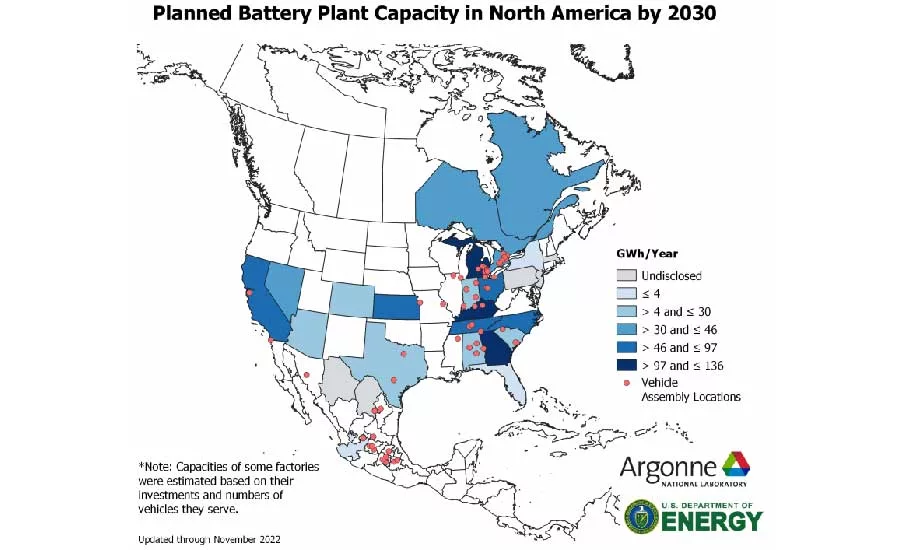

A wave of new planned EV battery plants will increase North America’s battery manufacturing capacity by the end of this decade. Illustration courtesy Argonne National Laboratory

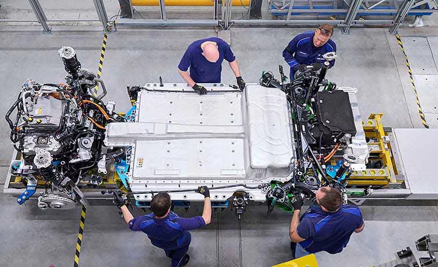

To optimize supply chain logistics, many battery factories will be colocated with vehicle assembly plants. Photo courtesy BMW AG

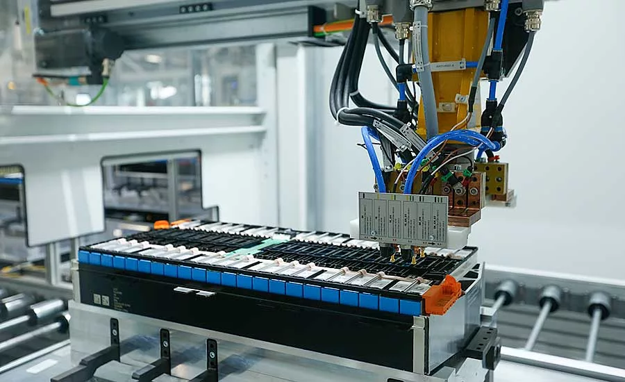

Battery manufacturers will soon be forced to implement new systems that allow for continuous improvement, boost production, enhance quality and ensure safety. Photo courtesy BMW AG

According to a recent report conducted by Argonne National Laboratory, a wave of new planned EV battery plants will increase North America’s battery manufacturing capacity from 55 gigawatt-hours per year (GWh/year) in 2021 to nearly 1,000 GWh/year by 2030.
Most of the announced battery plant projects are scheduled to begin production between 2025 and 2030. By 2030, this production capacity will be capable of supporting the manufacture of roughly 10 million to 13 million all-electric vehicles per year.
To optimize supply chain logistics, many battery factories will be co-located with vehicle assembly plants. Most of the planned projects in the U.S. are concentrated along a north-south band from Michigan to Alabama. Based on current plans, Georgia, Kentucky, Michigan and Tennessee will see the highest growth in battery manufacturing capacity.

Optical systems differ from mechanical systems. They use optical sensors, cameras and 3D-like scanners to “see” the part location instead of simple mechanical measurements. Optical positioning systems enhance the battery manufacturing process by improving the ability of equipment to complete a specified process in the exact location required, even if the battery block is out of position.
The system adapts to each battery block in the process and verifies accuracy before, during and after welding or other operations. This lowers cost in the long run by reducing the need for human inspection while boosting quality.
Speed and quality of battery pack assembly are influenced by the precision of the measurement and welding methods used in the process. The quality of assembly in EV battery production is the cumulative impact of part tolerances, assembly features and welded joint quality.
Because optical systems rely upon images, they can quickly be adapted to produce new types of batteries faster and at lower cost than changing a mechanical system. In addition, optical systems can easily be used in continuous process improvement to enhance manufacturing tolerances and product quality, while reducing downtime during product line changeovers.
