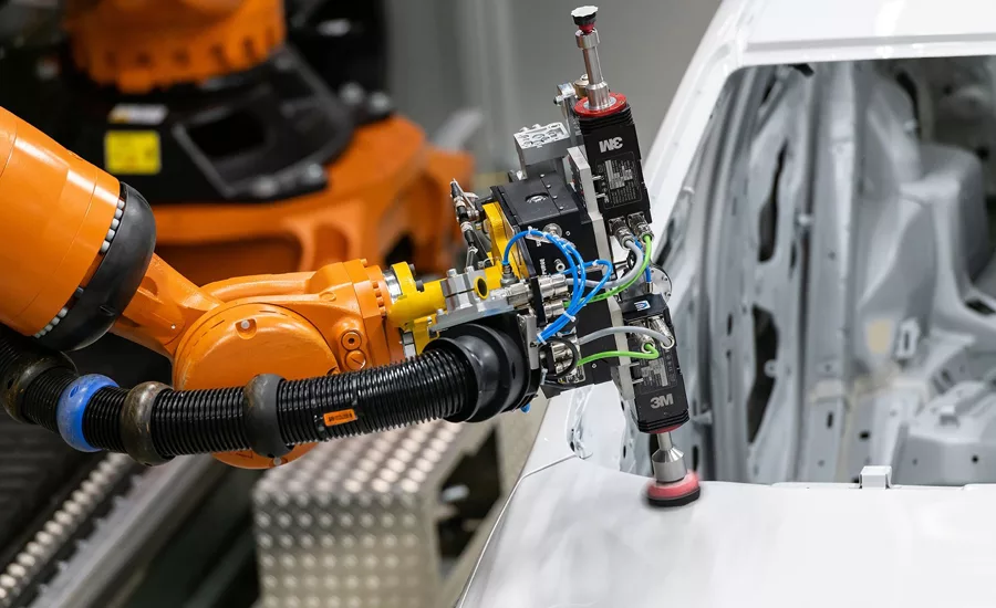

On the paint line, four robots stand in the processing booth, surrounding a freshly painted body. As if on command, the robots begin working on the surface of the body. They sand it, apply the polishing compound, polish, change the attachments and switch out the sandpaper. Cameras track the action.
“What is unique here is that the robots work on each body exactly where needed, because the tiny specks and bumps that can appear after the topcoat is applied and that we want to remove are in different spots on each vehicle,” explains Stefan Auflitsch, head of production paint application and finish at the plant. “Robots are normally programmed to follow the same pattern until they are reprogrammed. Using artificial intelligence allows them to work in a more tailored manner. With up to 1,000 vehicles going through the finishing process every working day, that adds up to 1,000 unique processes.”

However, there are limits to the use of robots. For example, they cannot process the edges of the body or the final millimeters next to the door and other joints. The fuel filler flap is also too fragile. For this reason, it is ultimately trained employees who add the finishing touches and conduct the final inspection of the body. However, the AI data is just as helpful for human workers as it is for the robots. A laser projector digitally marks the relevant areas of the body surface to ensure nothing is overlooked.
