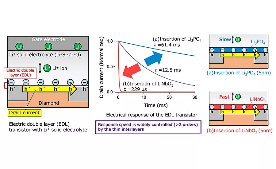

CONTROLLING SPEED DYNAMICS COULD IMPROVE ALL-SOLID-STATE BATTERIES
All-solid-state batteries hold big potential for next-generation electric vehicles, because they offer greater energy storage density, faster charging and better safety than current batteries. However, their high surface resistance causes these batteries to have low output, limiting their applications.
To overcome this challenge, engineers at the Tokyo University of Science have developed a way to modulate electric double layer dynamics at the solid-solid electrolyte interface.
“The electric double layer (EDL) effect occurs when colloidal particles gain negative electric charge by adsorbing the negatively charged ions of the dispersion medium on their surface,” says Tohru Higuchi, Ph.D., associate professor of physics and material science at Tokyo University of Science. “This occurs at the solid-solid electrolyte interface, posing a problem in all-solid-state lithium batteries.”
Higuchi and his colleagues recently developed a way to quantitatively evaluate the EDL effect. They used an all-solid-state hydrogen-terminated diamond (H-diamond)-based EDL transistor (EDLT) to conduct Hall measurements and pulse response measurements that determined EDL charging characteristics.
By inserting a nanometer-thick lithium niobate or lithium phosphate interlayer between the H-diamond and lithium solid electrolyte, the engineers could investigate the electrical response of the EDL effect at the interface between these two layers.
“The electrolyte’s composition did, indeed, influence the EDL effect in a small region around the electrode interface,” explains Higuchi. “The EDL effect was reduced when a certain electrolyte was introduced as an interlayer between the electrode-solid electrolyte interface. EDL capacitance for the lithium phosphate/H-diamond interface was much higher compared to the lithium niobate/H-diamond interface.”
The engineers also improved the switching response time for charging all-solid-state electric double layers (ASS-EDLs).
“The EDL has been shown to influence switching properties, so we considered that the switching response time for charging ASS-EDLs could be greatly improved by controlling the capacitance of the EDL,” says Higuchi. “We used the non-ion-permeable property of diamond in the electron layer of the field-effect transistor and combined it with various lithium conductors.
“The interlayer accelerated and decelerated the EDL charging speed,” Higuchi points out. “The electrical response time of the EDLT was highly variable. It ranged from about 60 milliseconds (low-speed switching for lithium phosphate/H-diamond interface) to about 230 microseconds (high-speed switching for lithium niobate/H-diamond interface). However, we controlled the EDL charging speed for over two orders of magnitude.
“These results are important for improving the interface resistance and may lead to the realization of all solid-state batteries with excellent charge-discharge characteristics in the future,” claims Higuchi.
