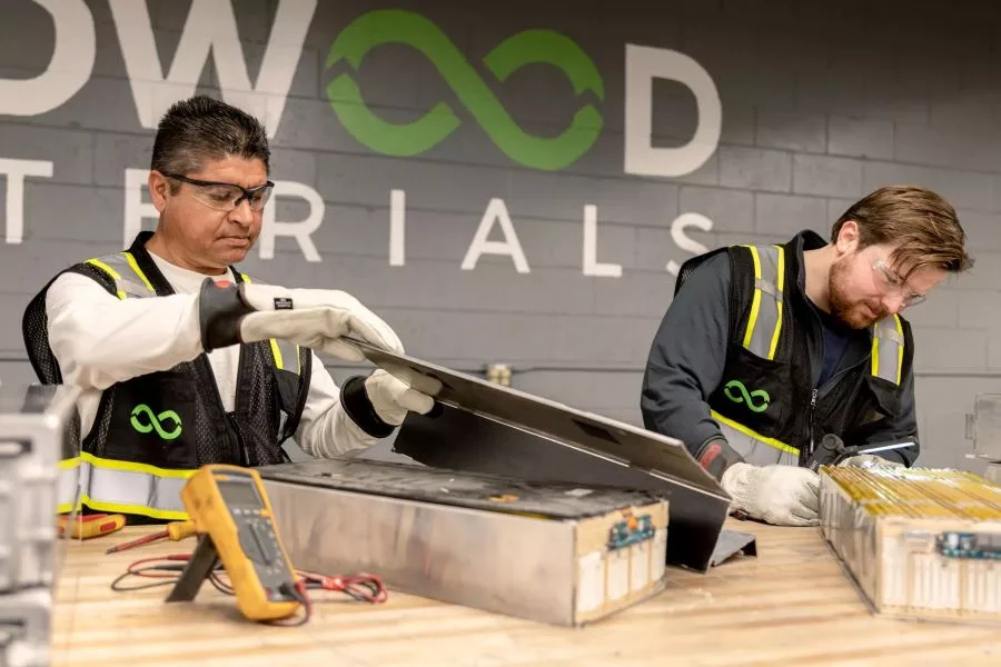

Mechanical processing is the simplest technique. It is employed by many players globally, and is typically the initial step in lithium-ion battery recycling. This often starts with a disassembly step, which is performed manually due to differences in EV battery pack design. However, it requires a skilled workforce.
After disassembly, typical steps include shredding, grinding and crushing. This breaks down the high-value materials, separates them from foils and casings. This recycling step must be performed in an inert atmosphere. Often, sieving is used to separate larger fragments of current collectors, casings and separators from electrode materials, which are constructed of very fine powders.
