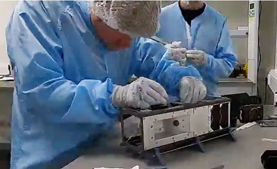

assembling the ForgeStar satellite
Most of the ForgeStar components will be assembled in-house. Illustration courtesy Space Forge Ltd.

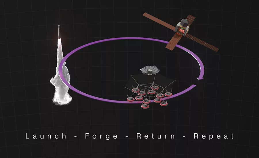

manufacturing in space
Space provides an optimal manufacturing environment for some products, because of zero gravity, extreme temperatures and vacuum conditions. Illustration courtesy Space Forge Ltd.

Space Forge’s mission statement follows a simple mantra: launch, forge, return and repeat. The first step has recently become feasible, due to the advent of commercial launch providers such as Blue Origin, SpaceX and United Launch Alliance.
