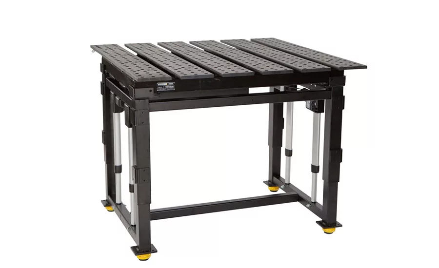

Welding tables are equipped with actuators to raise and lower loads 12 inches at the touch of a button. Photo courtesy BUILT Systems

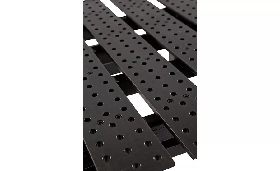

The nitride-coated work surface consists of a series of plates, 5/8 inch thick, spaced 1.7 inches apart to enable modular fixtures.

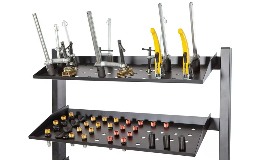

Produced in two standard sizes, this six-shelf cart comes with cutouts shadowed in yellow for each tool in a welder’s tool set from Strong Hand Tools. Photo courtesy BUILT Systems

BUILT’s welding tables are particularly popular. The tables are made from rigid, cold-rolled steel and equipped with heavy-duty, 6-inch locking casters. The base height for the table is 36.5 inches. High-performance actuators raise and lower loads 12 inches at the touch of a button, for smooth, ergonomic operation.
The nitride-coated work surface consists of a series of plates, 5/8 inch thick, spaced 1.7 inches apart to enable modular fixtures. Each plate has holes, 5/8 inch in diameter, in a 2-inch grid.

The tables come in three models: 1000, 3000 and 6000. The 1000 is 22 inches wide and 38 inches long and can lift 1,000 pounds. The 3000 is 46 inches wide and either 47, 78 or 94 inches long. It can lift 3,000 pounds. The 6000 is 46 inches wide and 94 inches long. It can lift 6,000 pounds.
A mobile tool cart is also available. Produced in two standard sizes, this six-shelf cart comes with cutouts shadowed in yellow for each tool in a welder’s tool set from Strong Hand Tools. The small cart is made to hold the standard 80-piece set, while the large cart holds the standard 120-piece set.
