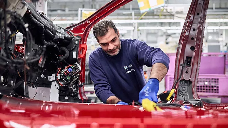

worker assembles an electric vehicle
Fastening is ideal for electric vehicles, because it enables engineers to join a variety of lightweight, dissimilar materials.
Photo courtesy BMW AG
