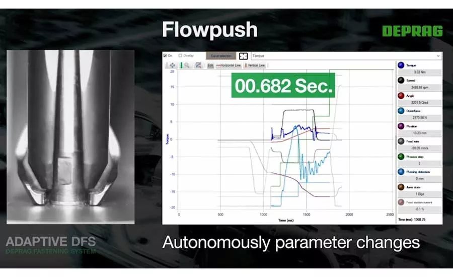

Component tolerances such as deviating positions, hole locations, material thickness, layer gaps, screw length tolerances or structural differences have a significant role in ensuring high screwdriving quality. Current solutions on the market for screw assembly systems respond to these parameters with separate determination for each screw position which is time-consuming. This prior-generation equipment provided the stroke movement and down-force by an air cylinder with a proportional valve. The behavior of the compressed air prevented individual processing steps from being followed with any accuracy. There is a danger that if the screwdriver speed or pressure is reduced too early, the funnel is not fully formed, and a heightened drilling torque could destroy the screw or the component. Any delay in the transition could damage the newly created threads— compromising the joint altogether.

The communication between a twin-closed-loop system allows the automatic recognition of the penetration of the material layers.
An ideal assembly should use a “closed loop” and adaptive assembly unit that combines EC-Servo screwdriving technology with EC-Servo stroke technology. The communication between a twin-closed-loop system allows the automatic recognition of the penetration of the material layers—independent of the material- or screw-tolerances. Such control could continuously evaluate the relevant feedback from the control modules and automatically optimize the process. This could be done by adjusting the process variables such as contact pressure, feed-rate, stroke distance, and speed. The system also ensures the ideal processing parameter, which means:
