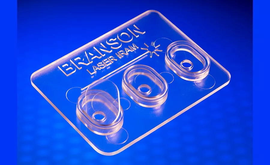

Clear-on-Clear Welds
Simultaneous Through-Transmission Infrared (STTIr) laser welding technology enables manufacturers to produce clear-on-clear welds that are particulate free, aesthetically pleasing and provide a hermetic seal. Co-developed with Sono-Tek, the technology involves applying a thin, laser-absorbing film (0.5 millimeter wide) along the weld line. Then, multiple stationary laser beams, shaped by custom wave guides, weld the joint. Discrete beam-zone intensity control via a tool map protects delicate structures while ensuring a uniform weld. STTIr does not use vibration force, making it ideal for applications involving geometrically complex devices.

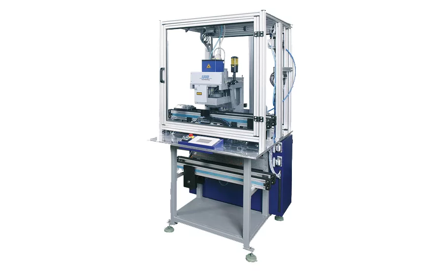

Laser Welding Cell
InlineWeld systems consist of a welding head and a separate control cabinet. The welding head contains the laser entry (collimation block); optics; scanner for controlling beam motion; clamping module; and upper clamp tooling. The control cabinet houses the laser source, chiller, PLC, Siemens HMI and optional PC.
The basic system is completely customizable with optional accessories. Modular construction permits simple and cost-effective adjustment of the system to any type of application by selecting the optimum laser power and optical components. The clamping device is fast and efficient, and can handle a wide range of different components.
Because the control cabinet can be installed in a separate location from the welding head, the cell easily fits into pre-existing assembly lines.

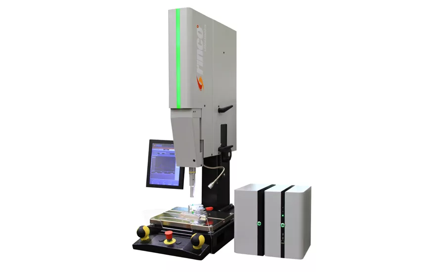

Servo-Driven Ultrasonic Welder
The downward force for the Dynamic 3000 ultrasonic welder is supplied by an electric linear actuator instead of a pneumatic cylinder.
The process parameters can be regulated individually and finely, including positioning of the sonotrode, applied welding force, and welding rate.
The 20-kilohertz welder is equipped with a high-performance industrial PC that can be comfortably operated via a 12-inch touch screen. The welding process is triggered via an ergonomically designed two-hand switch.
Because the starting position of the ram can be freely selected, the weld cycle can be shortened, depending on the geometry of the object to be welded. The welding mode can also be freely selected. A total of eight modes are available: from time, distance and energy-related modes, to a combination of time and energy, and a mode for presetting the melting rate. For all welding modes, the ultrasonic trigger can be adjusted according to force, distance, time or an external signal. Depending on the welding mode, the actual welding process can be subdivided into as many as ten steps.
With this level of detail, the welding process can be controlled far more accurately than with a pneumatic drive. Even a speed-dependent or force-dependent weld profile can be achieved. Even parts that were previously difficult to weld can be joined reliably using electrical motion with a reproducible and uniform weld seam.
The welder is operated via the graphic user interface. Individual user accounts, with the relevant authorizations, can be set up for each level of the employee hierarchy. Weld characteristics are shown clearly in the form of graphs, and the results and parameter data sets can be exported to a data carrier. All parameter changes and events (for example, maintenance cycles) are recorded in the system and documented in the nonerasable audit trail. In the event of problems, a service technician at Rinco headquarters can access the machine via an Internet connection, quickly come up with a diagnosis, and in most cases, directly correct any parameter errors.

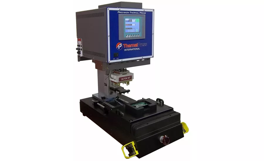

Thermal Press for Heat-Staking, Swaging, Sealing
The C-Series thermal press has an open C-frame format to accommodate all sizes of parts and assemblies. The press lends itself well to many tooling and part handling options. It is fully self-contained and can easily sit on most workbenches or tables.
The press can be used for heat staking, swaging, sealing, insertion, filter assembly, heat-seal connectors and hot-bar soldering.
The press is available in various heights and configurations to accommodate tall or deep parts. All systems are equipped with quick-change tooling. A 4-inch stroke with an adjustable hard stop is standard. It can apply a maximum force or 1,000 pounds. Ram speed is programmable.
