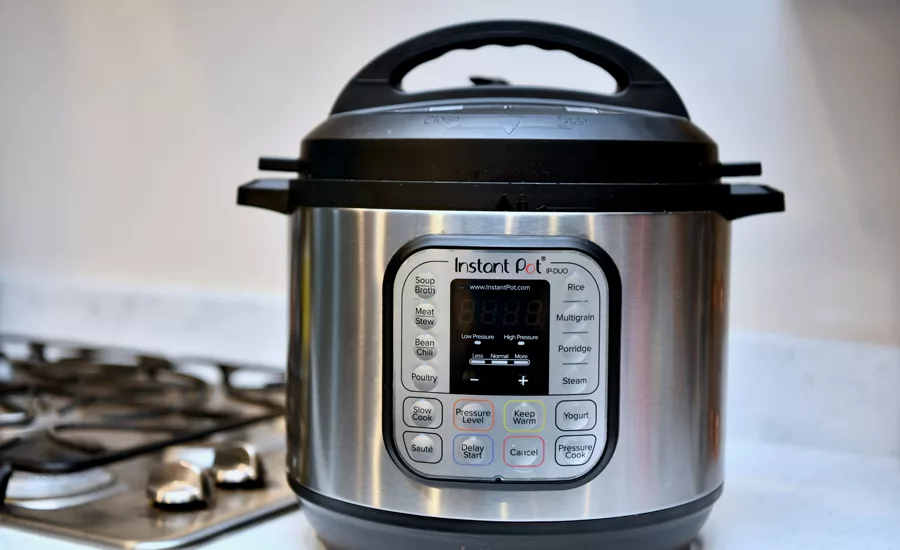

N95 respirators were intended to be discarded after every use. That’s not happening now, of course, so much research is going into devising methods for sterilizing used respirators for reuse. If that is your situation, the following information may be helpful:
Bleach, isopropyl alcohol and hydrogen peroxide all kill viruses—but also destroy the fabric integrity. Autoclaves can also kill viruses, but most assembly plants don’t have spare autoclaves. However, some valuable work has been published recently about a simple, inexpensive way to repeatedly sterilize N95 respirators using a simple inexpensive rice cooker. The first published study was conducted with Farberware rice cookers (Model No. WM-CS6004W), but the Instant Pot rice cooker has been used in other studies. (Very important: Do not reuse the cooker for food.)
Heating respirators for 50 minutes at 212 F—the default setting on most rice cookers—effectively resulted in sterilization. Respirators, including straps, can tolerate that temperature pretty well, but it’s necessary to line the cooker with paper to form a barrier between the respirator and the based and walls of the cooker.
More recent research indicates that moist heat at the same temperature works better and faster. If you’d like to investigate, there’s a very technical NIH online paper here or a simplified explanation here. The Department of Homeland Security site offers some PDFs about selecting and using a rice cooker for decontamination.
Do not rotate respirators among people. Once a respirator has been used by a person, it must be used solely by that person even after sterilization. Put identifying markings (that can tolerate sterilization conditions) on every respirator.
