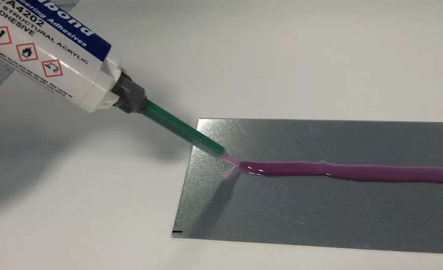

A less expensive alternative to meter-mixing equipment is dual-cartridge dispensing, which uses handheld dispensing guns. The easy-to-use plastic cartridges isolate the user from the material, the material is on ratio and mixing is achieved by a static mixer.
This process is as easy as dispensing a tube of household caulk. Cartridges eliminate the need for expensive meter-mix equipment while maintaining the principles of meter-mix. Because dual cartridges are very mobile, they're ideal for field applications. Capacities range from 50 to 1,500 milliliters, but most assemblers prefer 200- or 400-milliliter cartridges. Cartridges typically can't be reused and must be disposed of.
