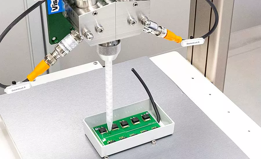

Many parts of electric vehicles are assembled with two-part adhesives and dispensing equipment. ILLUSTRATION COURTESY SCHEUGENPFLUG INC.
New Technology for Dispensing Two-Part Materials
Sensors are encapsulated to permanently protect sensitive electronic components from heat, moisture and vibration. PHOTO COURTESY VISCOTEC-AMERICA INC.
