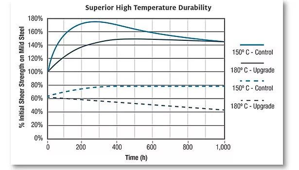

The latest heat-resistant retaining compounds can withstand continuous operating temperatures from 150 C to 180 C. Graph courtesy Henkel Corp.

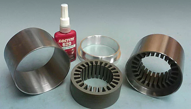

To reduce stress concentrations and prevent premature failure, a slip-fit bonded with an anaerobic retaining compound replaced an interference fit on the lobe of the eccentric shaft of a brushless motor. Photo courtesy Henkel Corp.

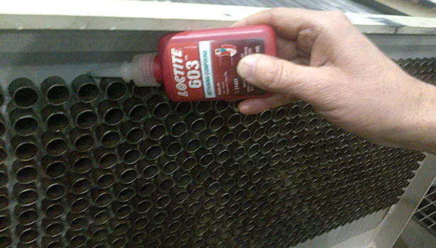

On industrial radiators, a time-consuming and costly brazing process on heat exchanger tubes was replaced with a slip-fit bonded with retaining compound. Photo courtesy Henkel Corp.

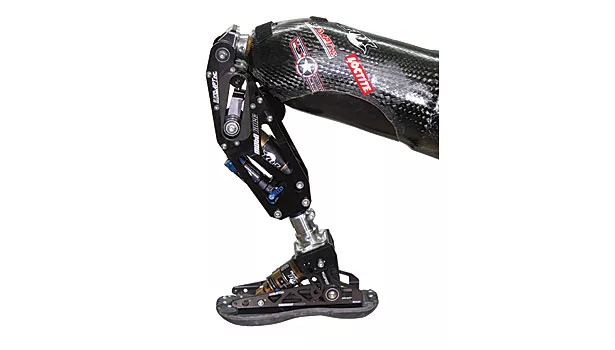

This prosthetic leg is designed for high-impact sports, such as motocross. A retaining compound keeps the leg’s bushings and bearings in place. Photo courtesy Henkel Corp.

Size, weight and efficiency are key parameters for most new interference or slip fit designs, targets that drive assemblies to higher operating temperatures. The latest heat-resistant retaining compounds can withstand continuous operating temperatures to 180 C. Even when high temperature capability is not required, these formulations increase the safety and robustness of the assembly.

To reduce stress concentrations and potential premature failure, a slip-fit bonded with an anaerobic retaining compound replaced an interference fit on the lobe of the eccentric shaft of a brushless motor. The new design enhances overall strength of the assembly and helps it operate over a sufficient temperature range, resist lubricating oils and withstand torsional stress. Loctite 7649 primer cleans the surface, accelerates cure and allows larger gaps to be filled. Loctite 620 high-temperature retaining compound grips the metal and locks the parts together. The new design relaxes tolerances and reduces part costs, simplifying alignment and reducing stress.

On industrial radiators, a time-consuming and costly brazing process on heat exchanger tubes was replaced with a slip-fit bonded with retaining compound. To eliminate leaks in the welded seams and resulting loss of static pressure, the heat exchanger tubes are inserted into the tubing sheets using a slip fit. Loctite 635 retaining compound is applied to the outer diameter of the tubes. The tubes are then expanded into the tube sheet. The new process is faster than brazing and does not require specialized labor.
