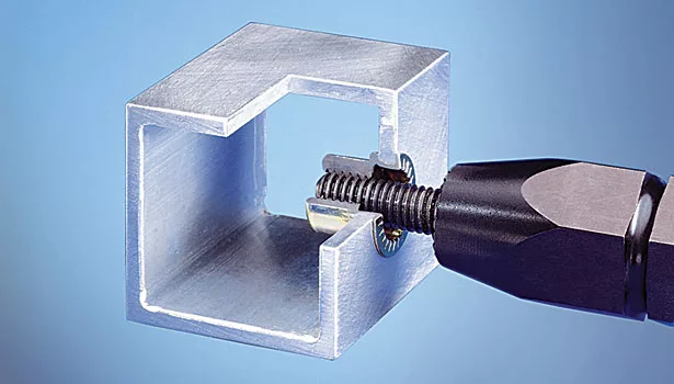

A rivet nut is a one-piece internally threaded and counterbored tubular rivet that can be installed while working entirely from one side of a panel. Photo courtesy PennEngineering

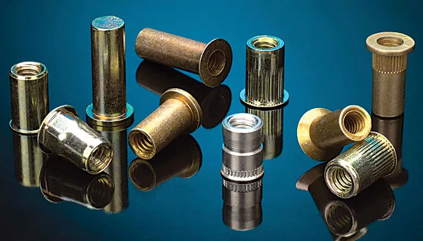

Rivet nuts can be made from aluminum, steel, stainless steel, Monel and brass. Photo courtesy PennEngineering

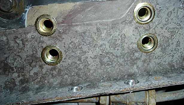

Automakers use rivet nuts extensively to attach parts to structural components. Photo courtesy CC Tech

A rivet nut is a one-piece internally threaded and counterbored tubular rivet that can be installed while working entirely from one side of a panel. As with a classic blind rivet, the body of the rivet nut is formed on the blind side. The back-side flange is large enough to resist being pulled out even under conditions of eccentric load. Because rivet nuts can be installed without accessing both sides of the panel, the fasteners are ideal for attaching parts to housings, tubes or extrusions. The fasteners can be installed into all metals, most plastics and even ceramics.

The fasteners can be made from aluminum, steel, stainless steel, Monel and brass. “The most popular material is zinc-plated steel, but you might specify stainless steel if you’re particularly concerned about corrosion,” says Richard J. Kull, product manager for rivet nuts at PennEngineering. “Stainless steel rivet nuts are often used in solar panel installations and other outdoor equipment.”
A single fastener size can typically accommodate a wide grip range. For example, a 0.42-inch long SpinTite rivet nut from PennEngineering offers a grip range of 0.02 to 0.08 inch. A 1.45-inch long rivet nut has a grip range of 0.35 to 0.5 inch.
Rivet nuts are available with a variety of head styles. A wide front-side flange provides a large load-bearing surface. This reinforces the hole and prevents push-through. It’s also possible to apply a sealant beneath the flange for weatherproof applications. A thick flange can act as a spacer and provide some extra push-out strength. Countersunk and low-profile heads ensure flush or near-flush installation. Wedges or knurls underneath the head are designed to bite into the mating material and prevent the fastener from turning in the hole.
“The wedge head is great for soft materials like plastic, fiberglass and aluminum,” says Kull. “However, rivet nuts are annealed, so they’re relatively soft. The wedges aren’t going to be very effective on steel parts.”
Rivet nuts also come in many body styles. The standard rivet nut is cylindrical with a smooth surface, but variations include splined, square and hexagonal bodies. Such variations are all designed to do one thing: keep the fastener from turning in the hole, particularly in softer materials, such as aluminum and plastic.
“If they’re not set just right, round rivet nuts can spin in the hole at high torque levels,” explains Lanni. “With a hex-shaped fastener, you don’t have that issue.
“The downside of a hex-shaped fastener is that it requires a hex-shaped hole. For some manufacturers…it’s cheaper to make a round hole than a hex-shaped hole.”
Rivet nuts are also offered in open- and closed-end versions. The latter are ideal for applications, such as attachment points on vehicle exteriors, in which the mating screw will not necessarily be present. The closed end thus prevents the ingress of water and dust into the interior of the assembly.

Rivet nuts can be installed with hand tools or, more commonly, power tools. The former are similar to tools for installing blind rivets. The latter can be handheld or mounted to a linear actuator for fully or semiautomatic operation. They can also be mounted to six-axis robots.
The simplest power tool for installing rivet nuts is the pneumatic “spin-spin” tool. The fastener is threaded onto a mandrel at the end of the tool. The fastener is then inserted into a hole in the workpiece. When the tool is actuated, the mandrel spins rapidly and powerfully, pulling the threaded portion of the rivet nut’s shank toward the blind side of the workpiece and forming a bulge around the unthreaded portion. The bulge presses against the rear of the panel, creating a clamping force that tightly grips the sheet. Once the rivet nut is clinched securely in place, the mandrel spins in the opposite direction, unthreading itself from the nut and leaving the fastener’s internal threads intact.
No additional finishing is required after setting, even with coated or painted components. Thus, rivet nuts can be fitted at any stage in the production process.
An upgrade from the spin-spin tool is the “spin-pull” tool. As with the spin-spin tool, an air motor threads the mandrel into the nut. When the fastener is inserted into the workpiece, hydropneumatic pressure is applied to pull back the mandrel a set distance. Once the fastener is set, the air motor re-engages to back the mandrel out of the nut.
A third option is the “pull-to-pressure” tool. It works the same as the spin-pull tool, but instead of pulling to a set distance, it pulls to a set pressure.
“If you’re fastening soft plastic, a spin-pull tool might be better,” says Lanni. “A pull-to-pressure tool might overset the fastener into the material. On the other hand, if you’re fastening metal or a hard plastic, like glass-filled nylon, a pull-to-pressure tool is more consistent.”

In the automotive industry, they are used to attach components to dashboards and firewalls. They are also installed in the chassis and body frame to attach radiators, roof racks, spoilers, and plastic fenders and fascia. An aftermarket hard top for the Jeep Wrangler is attached with rivet nuts.
