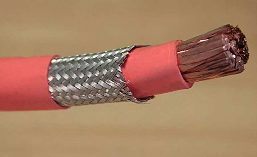

Within every hybrid and electric-powered vehicle, there is a plethora of wire and cable. All of it is essential, but only a small portion stands out because of size, appearance or high-voltage capabilities.
The EXRAD 1,000-volt (UL 758 rated) battery cable is notable for all three reasons. Made by Champlain Cable Corp., the 4/0 AWG cable measures nearly 1 inch in diameter and weighs 0.876 pound per foot. Its irradiated cross-linked elastomer (XLE) jacket is only 0.08-inch thick yet strong enough to isolate any stray current. The jacket’s bright orange color means EXRAD meets EU standards for high-voltage cables.
Beneath the jacket is a tinned copper braid shielding. It provides 95 percent coverage of the cable’s thin inner XLE insulation (0.12-inch thick), which surrounds 30 strands of bare copper wire. More importantly, the shielding simultaneously prevents emission of electromagnetic pulse (EMP) waves and protects data and signal conductors from external electromagnetic interference (EMI).

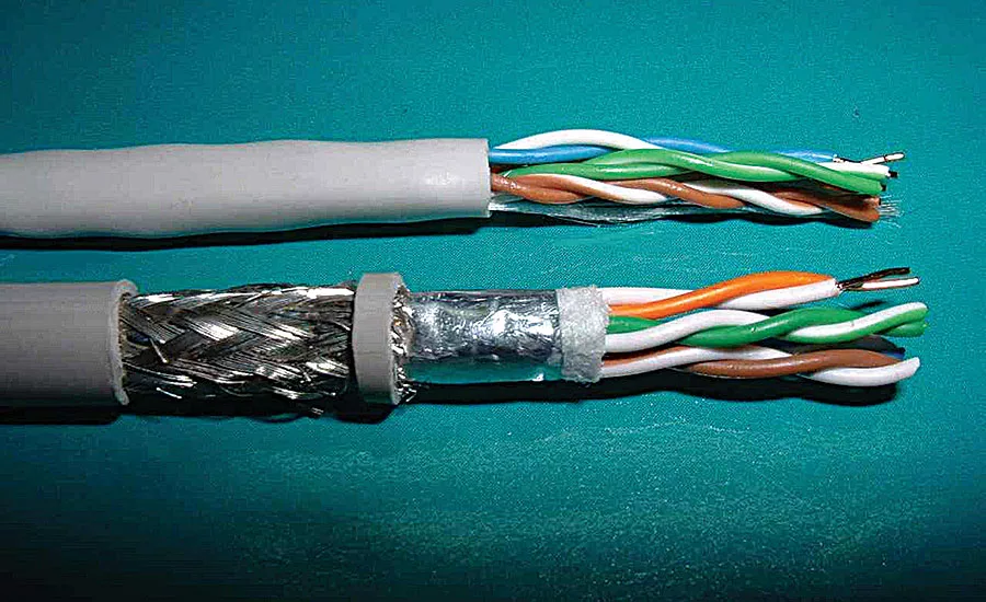

Another type of spiral shielding is twisted pairs, which was invented and patented by Alexander Graham Bell in 1881. The two insulated conductors are uniformly twisted around each other the full length of the harness to minimize interference from other twisted pairs in the cable.

Braided shielding is tight but flexible, according to Goyette. The braid shield is formed of groups of small-gauge wires on bobbins. These are laid side-by-side in the braiding machine, then woven over and under one another. Braided shielding usually covers 95 percent of insulated wire.

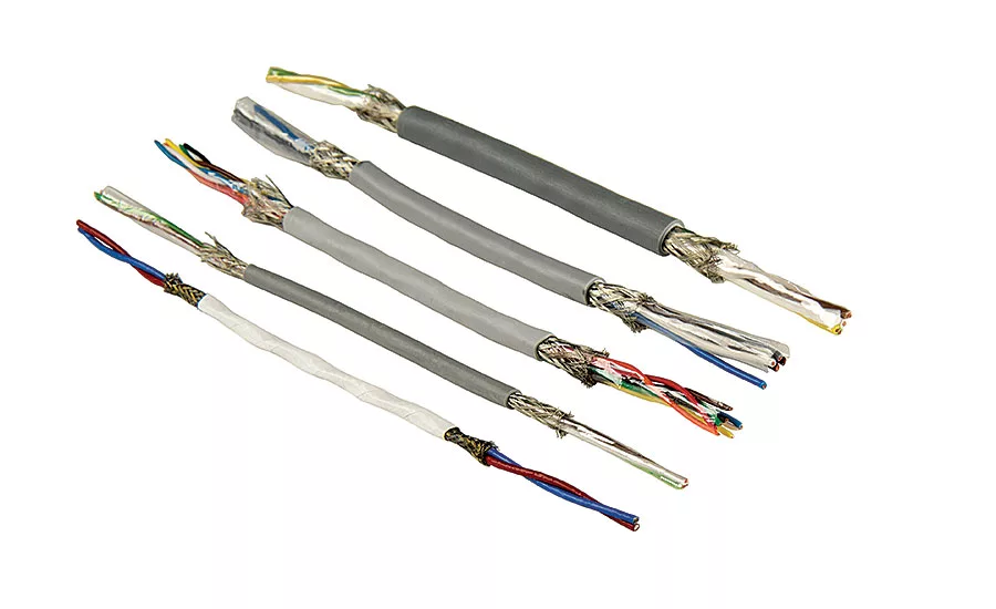

Harness manufacturers often need to unbraid and cut the braided shield from shielded cable as  part of the termination process. Pete Doyon, vice president of product management for Schleuniger Inc., says his company has developed a prototype machine (ShieldCut 8100) to quickly unbraid the braided shield and cut it to a preprogrammed length. Its targeted end-users include the military and aerospace manufacturers.
Currently available from Schleuniger is the JacketStrip 8310 slitter. This machine features rotating blades that axially and radially slit the outer jacket of out-of-round and multiconductor cables without damaging the shielding or inner conductors. It handles 0.1- to 1-inch OD cable up to 19.7 inches long. The semiautomatic slitting machine offers simple operation and short cycle times.
Foil shields consist of a very thin (0.0003 inch) metalized flexible plastic film that is spiral wrapped around the insulated wire. Because it is aluminum, the film needs to be crimped and is often combined with a noninsulated drain wire (current diverter) wrapped within a cable. The drain wire contacts the foil and is connected to ground at the harness source end to negate EMI.
To achieve 100 percent shielding effectiveness, a loose braid may be placed over the foil. This method works well as long as the cables are flexed only during installation and maintenance.
