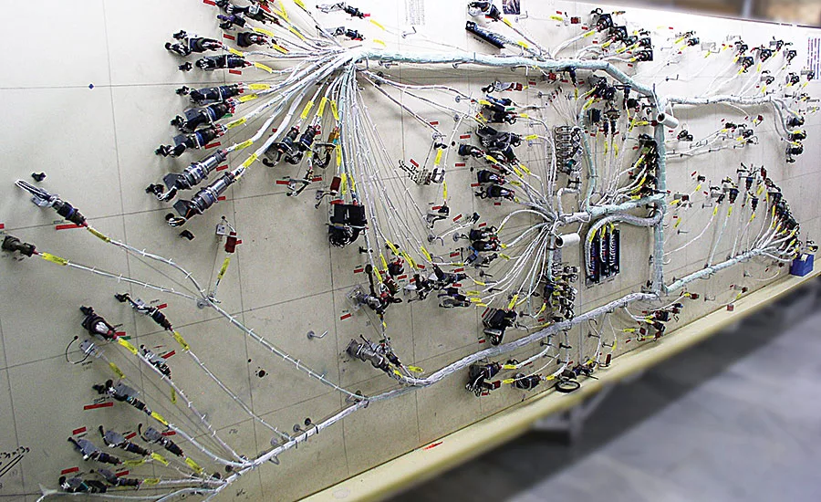

The wiring in an aircraft can weigh more than 1,000 pounds. Conductors and EMI shielding made from carbon nanotubes could reduce the weight of such wiring by 80 percent.

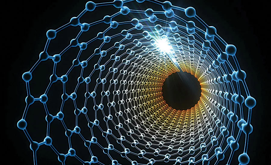

A carbon nanotube is composed of a single layer of carbon atoms in a cylindrical configuration. Illustration courtesy University of Cambridge

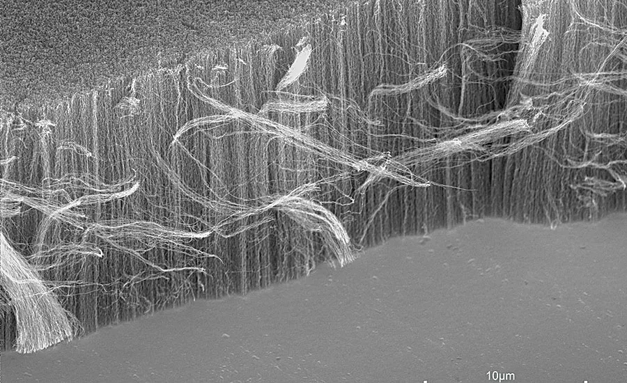

One method of making carbon nanotubes involves growing them on a metal or silicon substrate like a forest or carpet. Photo courtesy University of Cambridge

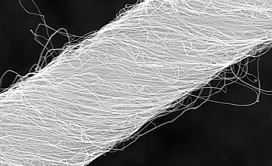

CNT fibers can be spun into conductive yarns that could someday replace copper wire in wiring harnesses and motor windings. Photo courtesy CSIRO

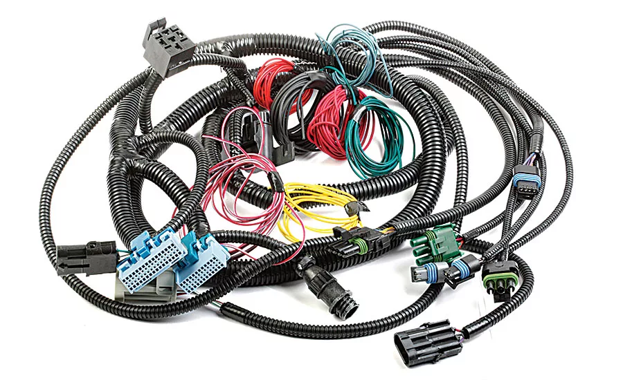

Carbon nanotubes promise to dramatically reduce the weight of automotive wiring harnesses like this one. Photo courtesy Holley Performance Products

For example, an average vehicle contains more than 55 pounds of copper, most of it electrical wire. An electric car might have three times that amount. Reducing that weight would mean better fuel economy or, in the case of electric cars, more time between charges.

A carbon nanotube is composed of a single layer of carbon atoms in a cylindrical configuration. The tubes can be single-walled or multiwalled. CNTs have been constructed with a length-to-diameter ratio of up to 132,000,000-to-1.
That long aspect ratio—only a few nanometers in diameter but several millimeters in length—gives CNTs some remarkable properties. At the nanoscale, at least, individual CNTs have a tensile strength greater than steel, conductivity greater than copper and thermal dissipation greater than diamonds. They also resist corrosion and fatigue.

But perhaps the most intriguing way to use CNT fibers is to spin them into conductive yarns that could someday replace copper wire in wiring harnesses and motor windings. The driving force behind this application is weight reduction.
Consider an RG-58 coaxial cable. The weight of a standard copper construction is 38.8 grams per meter, says Stefanie E. Harvey, Ph.D., senior manager for corporate strategy at TE Connectivity. Replacing the copper braid with CNT tape would reduce the weight to 11.5 grams per meter. Replacing the center conductor with CNT yarn would further reduce the weight to 7.3 grams per meter, for a total weight savings of 80 percent.
Such a reduction equates to hundreds of pounds in an aircraft, says Harvey. For example, the F-35 fighter contains approximately 15 miles of cable. If the copper shielding on all that cable were replaced with CNT tape, the total weight of the cabling could be reduced by approximately 1,180 pounds, she says. If the shielding and the conductors were replaced with CNT materials, the total weight savings would be 1,975 pounds.

There are several methods of making CNTs. One method is a chemical vapor deposition process. Another method involves growing the fibers on a metal or silicon substrate like a forest or carpet.
