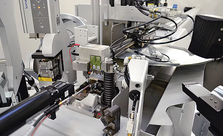

“Many wire harness manufacturers make a mistake when they fail to invest in a machine because they don’t have enough business to justify the initial purchase,” says Hill, who is also vice president and secretary of the Wiring Harness Manufacturers Association. “Our approach has always been, if the machine will streamline our operation or if it will improve the quality of our products, then we should buy it. We may not have enough business to justify the investment right away, but we can always find business if we deliver the best, most accurate products.”
Unconventional wisdom? Perhaps not. In recent years, Precision has invested more than $500,000 in advanced manufacturing technology, including a pair of fully automatic crimp centers. (A third may be coming soon.) At the same time, the company has seen its annual revenues soar 425 percent since 2002.
“I’ve never regretted investing in wire processing equipment. I’ve always been able to keep it busy,” says Hill. “We have the latest and best equipment on our floor, which helps us meet the demands of our customers.”

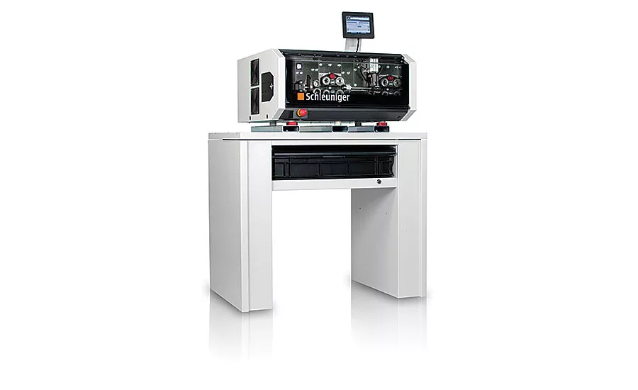

Such was the case with the most recent machine purchased by Precision Manufacturing: a PowerStrip 9550 automatic cutting and stripping machine from Schleuniger Inc. The company bought the machine to cut and strip thick battery cables.

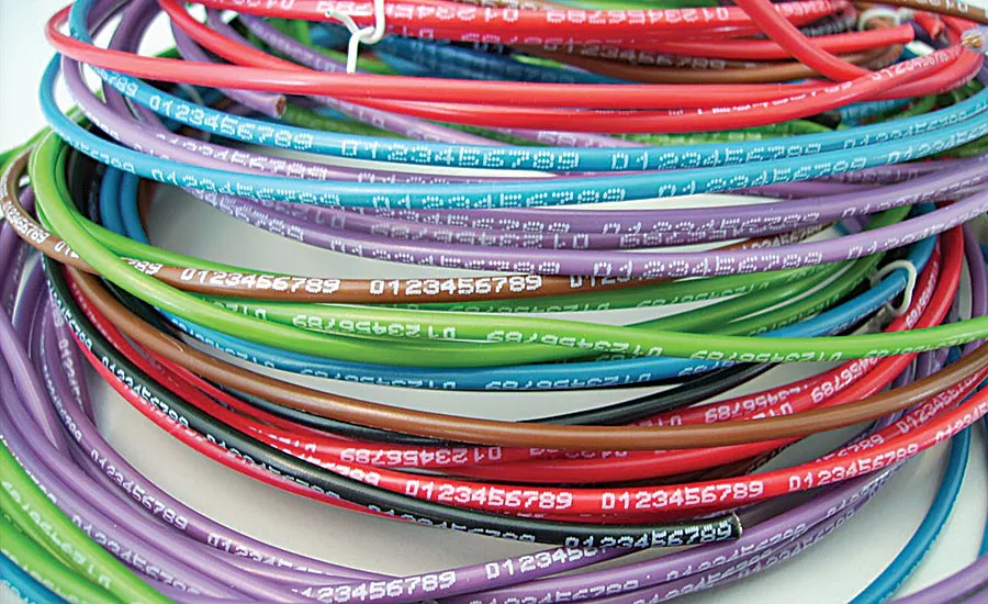

“A lot of our customers want wire marking,” says David Elliott, operations manager at AIM. “If you’ve got a long harness with 40 wires, the ability to quickly identify a wire or circuit number can really help during repair or retrofitting.”

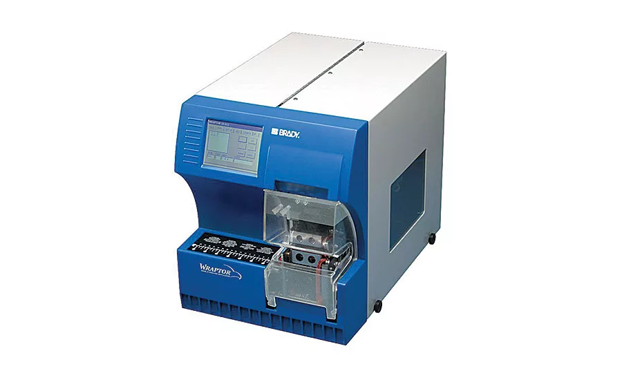

As a result, the company recently purchased three new ink-jet machines for marking wire. One of the new printers is located in-line with an automatic cutting and stripping machine. The company also added a Wraptor labeling machine from Brady Corp. The semiautomatic machine prints and wraps an adhesive-backed label around wires or cables ranging from 0.06 to 0.6 inch in diameter.

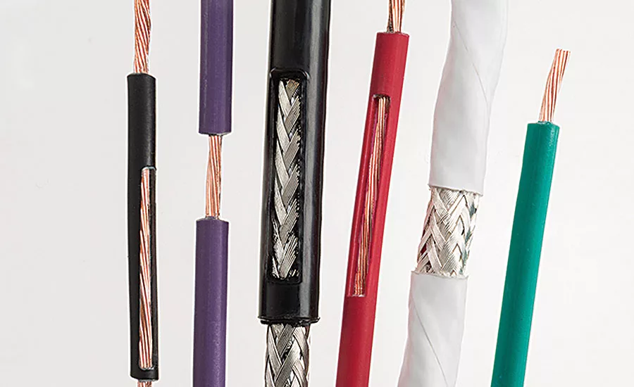

Located in Fairport Harbor, OH, the contract manufacturer specializes in wire harnesses, cable assemblies, over-molded products, control panels and electromechanical devices. Last year, MJM added a laser wire-stripping machine to its operation. The machine precisely removes the insulation from wires without damaging the underlying conductors. That’s particularly important when processing fine-gauge wires.
Applications range from aircraft power leads to wires for dental and medical drills, hearing aids, catheters, pacemakers, ultrasound transducers and other devices. Automotive applications include electronic cables, air bag harnesses, small motors and actuators.
