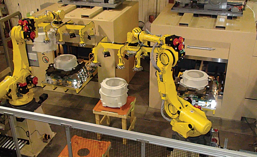

A large appliance manufacturer uses two custom vibration welders to weld thermoplastic tubs for front-loading washing machines. The production rate is about 1,000 tubs per 8-hour shift. Photo courtesy Forward Technology

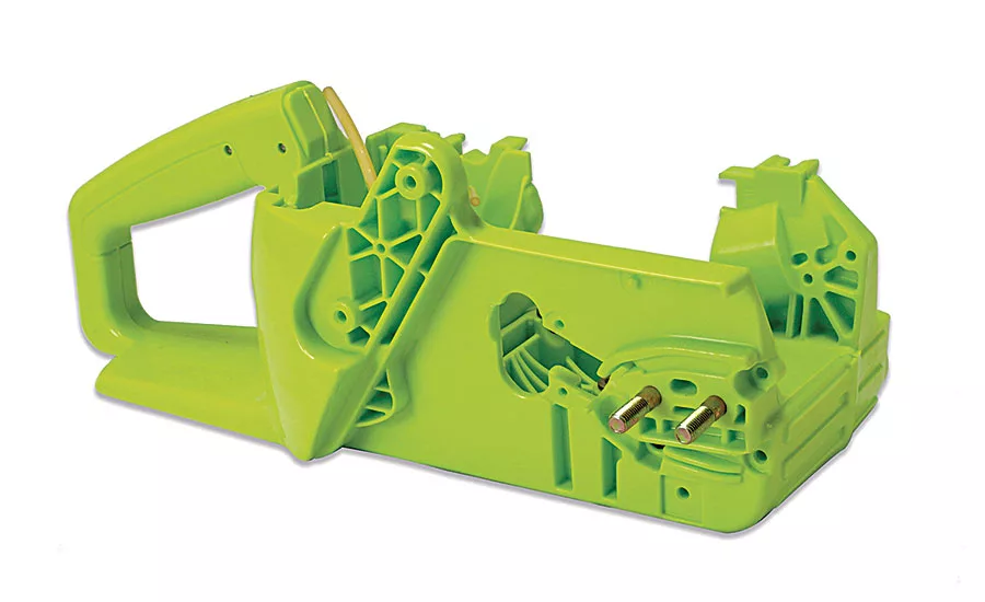

Manufacturers of lawn and garden equipment use vibration welding to assemble a wide range of products, including chainsaw housings. Photo courtesy Dukane Corp.

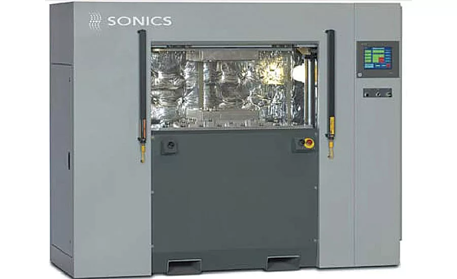

MX welders have an Auto-Tune feature that automatically detects, sets and locks-in the platen’s optimum frequency within seconds. Photo courtesy Sonics & Materials Inc.

For example, several years ago, Forward Technology developed two custom vibration welders for a large appliance manufacturer. Doug Grabinger, project manager at Forward, says the welders assemble tubs for front-loading washing machines. A large, stationary six-axis robot is positioned in front of each welder. Between the robots is a dual pallet-transfer system that brings sets of unwelded parts into the work cell on conveyor one (furthest from the robots) and moves welded tubs out of the cell on conveyer two. A separate conveyor for rejected tubs is located behind each robot.
To start the process, the bottom tooling of the welder opens, and the robot grabs a set of tub parts from conveyor one and places the set in the tooling, which closes. After the tooling re-opens, a sensor measures the welded tub’s stack height. If it’s within tolerance, the robot removes the welded tub and places it on conveyor two. If the tub is out of tolerance, the robot removes the tub and places it on the reject conveyor, which moves it to another cell for further evaluation and inspection.
The robot then lifts a new set of parts off conveyor one, reloads the tooling, and the process repeats. Grabinger says the production rate is about 1,000 tubs per 8-hour shift.

“Today, manufacturers want and need to control the vibration welding process as much as possible,” explains Brian Gourley, North American sales manager for welding at Sonics & Materials Inc. “The good news is the HMI on most welders lets end-users quickly and easily change weld time, amplitude, pressure, hold time, depth, and or energy by simply touching the display panel.”
Gourley says the company’s MX welders have an Auto-Tune feature that automatically detects, sets and locks-in the platen’s optimum frequency within seconds. This feature helps vibrate the platen at maximum efficiency with minimal power.
The MX welders also enable manufacturers to preprogram parameters so they change duringeach welding cycle. For example, within a 20-second cycle, the operator may need one parameter to change at the 5-second mark, and another parameter to change at the 9- or 10-second mark.
