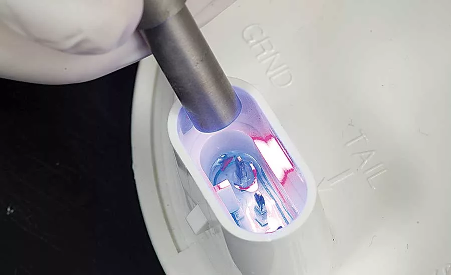

Several Tier 1 suppliers use Novagard’s RTV 800-260 conformal coating for potting conductors on the back of halogen headlight bulbs. The UV-cure adhesive is placed to a depth of 0.125 inch and length of 0.8 inch, and cures in 3 seconds. Clear in color, the adhesive has a viscosity of 2,000 to 5,000 centipoise. When cured, it offers 100-psi tensile
strength and 100-percent elongation. To facilitate inspection, the adhesive fluoresces when exposed to UV light.

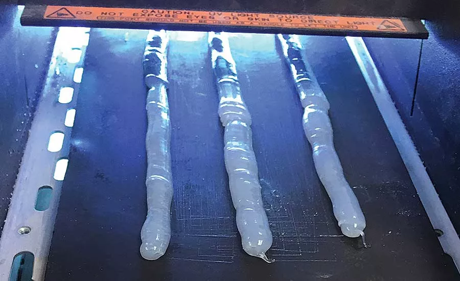

Equipment suppliers offer four types of UV-adhesive cursing systems: spot (for small parts), flood (large or many parts simultaneously), chamber (like a toaster oven) and conveyor (moderate to high-volume applications). Regardless of system type, Mike Kay, director of product management at Excelitas Technologies Corp, says it’s important to carefully determine the minimum and maximum amount of energy that can be used for each application.
“Figure out the minimum required energy to achieve bond, increase it to the maximum—in other words, when the cured adhesive turns brittle—and use this range to accurately set the irradiance energy level and duration,” explains Kay. “Then, be sure to check the light source’s irradiance with a radiometer on a regular basis. For medical devices, this can be as often as once or twice a day. Checking once a week is usually enough for less-exact applications.

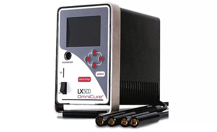

Last year, Excelitas introduced the OmniCure LX500 UV spot curing system that controls up to four UV LED Max heads simultaneously or independently with a single controller. Kay says the system is popular with manufacturers of medical devices (catheters, cannulas, endoscopes, syringes), electronics (optical pickups, smartphones, tablets), camera modules and microspeakers.
The LED Max heads produce up to 16 watts per square centimeter (wpsc) peak irradiance, while Intelli-Lamp technology provides optical stability for repeatable assembly and low operating costs. The system cures adhesives at three irradiance levels: 9 wpsc at 400 nanometers, 16 wpsc at 385 nanometers and 14 wpsc at 365 nanometers.
