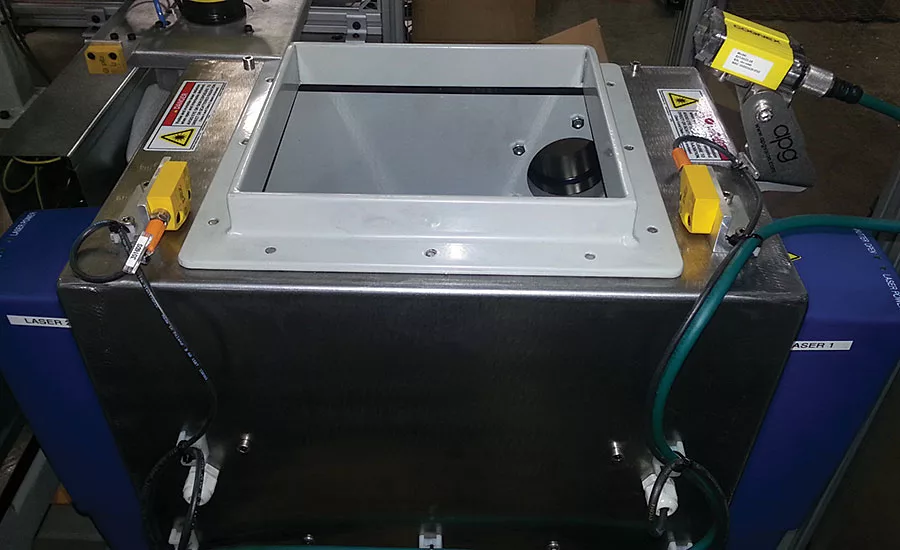

To ensure safety and precision, two Pulsed Fiber lasers were mounted opposing each other on each end of a stainless steel enclosure. The enclosure was designed and manufactured to ensure the laser markers would receive no direct line of site to the lenses while marking the assembly. The seams and joints of the enclosure were either welded or designed to overlap with the laser lenses extending through the enclosure into its interior.  Attachments to the enclosure, such as access holes for wiring and interface brackets, used seal tight fittings and gasket material for proper sealing.

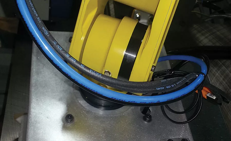

One of the biggest safety concerns was how to seal the enclosure when the robot presented a clutch pack to the lasers. To address this problem, the enclosure required a large opening to allow access for the robot. This application used a two-piece bracket and hood design. The bracket was mounted to the enclosure and surrounded the opening for the robot. The hood mounted to the robot between the end of the arm and the tooling, which is used to seal the enclosure.
While this design enabled the enclosure to be sealed, additional safety measures were needed. By using interlocked safety switches mounted to the enclosure and the hood, the machine is able to verify if the hood is in the proper position over the bracket before actuating the lasers.  Additionally, part presence sensors inside the enclosure verify the presence of the clutch pack, which are important in this application due to the configuration of the opposing laser markers.
